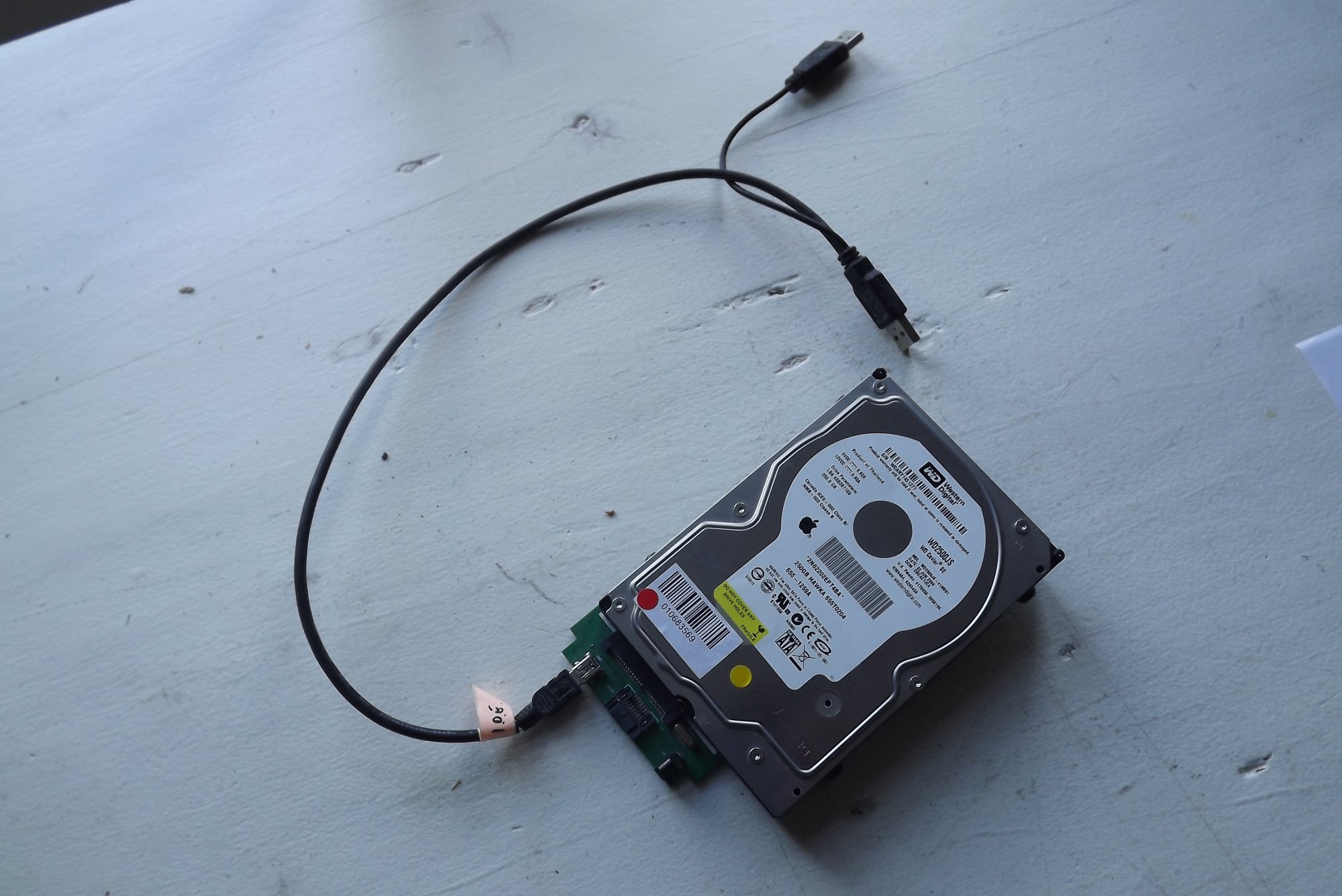

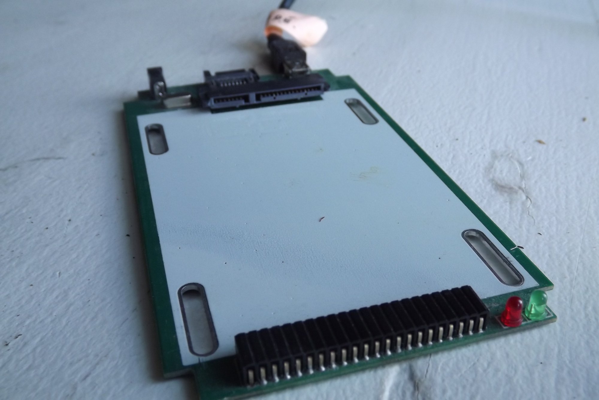

I have attempted to attach the internal 3.5 hd to a sata interface to a laptop (apple) but the drive does not power up. Or appear to work (no lights evident on the sata connector) or sound from drive powering up.Does the 3.5 inch internal hd need a separate power source?
What are you using to connect it to the laptop?
its a 2.5 sata /ide to usb enclosure.

I can fit the 3.5 drive into it if I take the board out of the enclosure
Ok, can you send a picture of how you have it set up?
Sorry for delayed reply...gmt Scotland. The main usb connection was connected directly to mac pro laptop...my friend suggested plugging in (to usb port) lighter usb cable to power the hd..it did not work....

While 2.5 inch drives can get power from USB alone I’ve never known a 3.5 inch drive that didn’t need a dedicated power source. You’re drive isn’t getting power from this setup. You need to put it in an enclosure designed for 3.5 inch drives or something like this:
