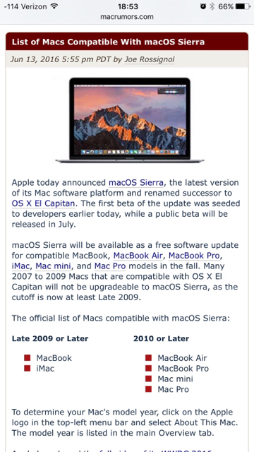

I don't believe your MBP is compatible with Sierra unless you plan to hack it.
Thanks guys-I'm well aware of the needed hacks to make it work and the hard work of @dosdude1 in getting it to work. I've been running it since the day it came out on my main computer, and since a few days after on an unsupported mid-09 MB.
My question pertains specifically to replacing the airport card in the MB 4,1-which will not work under Sierra-with a supported one so that I can get Sierra functional on it.
