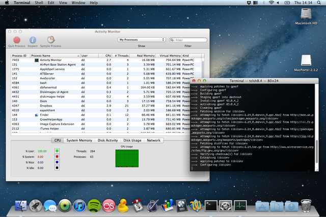

All the MacPorts are configured to be compiled with some GCC version, x. Like we have both said, it's probable that it won't work for you. When you get the bandwidth and upgrade your Xcode you are welcome to use my QEMU binary, I shall post it here along with performance improvements (if any).
Enjoy your trip to Singapore - I am jealous!
It's going to be a long night 😉
QEMU finished compiling a while ago - testing it out now - will post the binary in a bit...
