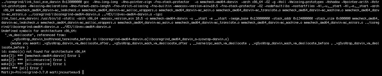

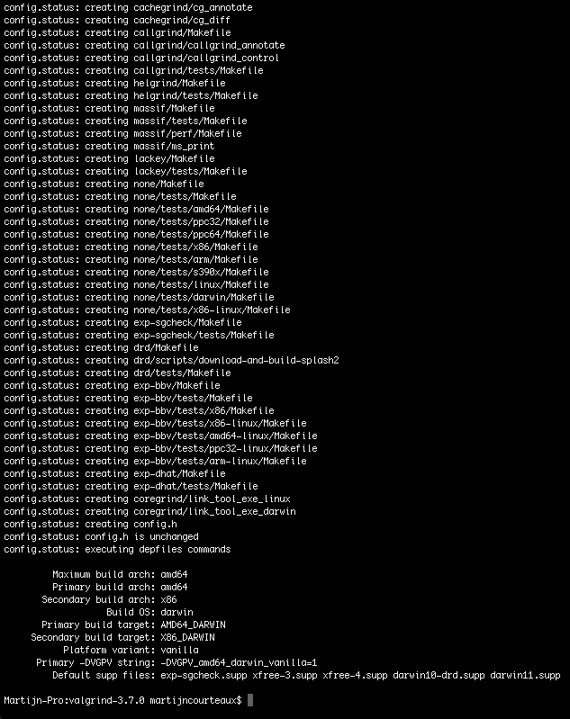

    What is happening is that the "configure" script is checking the version of OS X. It detects that I'm on OS X 10.8 and says it. What I tried doing was to edit the configure script to make it accept my version of OS X. This was successful, the script "configured" everything, but unfortunately, the compilation failed. Terminal output added as an image.

    Code:
    make
    [​IMG]
    Code:
    ./configure
    [​IMG]

    I don't know anything about valgrind or the details of your question but I have a few comments.
    A quick google of TASK_WIRED_LEDGER_PORT shows that it's in an Apple header file under the comment "Evolving and likely to change" So it's possible that these constants and functions simply no longer exist on 10.8. It's also possible that they moved to another header or are #ifdefed out for some reason. If they're gone then you may not be able to fix this problem.
    It's also possible that you don't have all your macros set up correctly and the reason for the undeclared symbol error is just an #include problem.
    Anyway you need to try to figure out the compile errors to understand why these few symbols aren't available.

    Thanks, I re-#define-d the macros manually in the correct file. Compilation got a lot further, but now, it gets stuck at here:

    Well, you're down to one linker error. Not bad.
    google tells me that vm_deallocate is part of the mach kernel. I assume that it's present in 10.8. I don't know for sure what library it's in. I guess you need to make sure that you're linking against the library that has that function.
