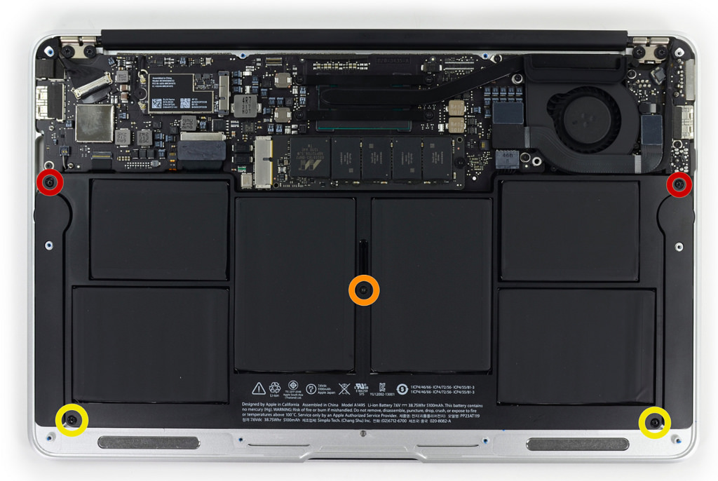

It is possible that the battery is preventing the air from powering up.
Next time this happens, disconnect the battery, connect the charger, don't touch any keys or the power button, and the air should power up on its own in about 30 to 60 seconds. If it does, it is a good bet that the battery is defective.

The battery isn't removable, unfortunately. But I'll keep the battery in mind if this starts to happen again!
It's definitely removable. Use a pentalobe driver to remove the bottom casing and disconnect the battery cable from the motherboard.

You don't need to be "tech savvy" if you can follow a repair guide and if you have the right tools to do the job...
fixit link that Audit13 posted is very easy to follow and provides a step by step guide on how to remove the battery...
