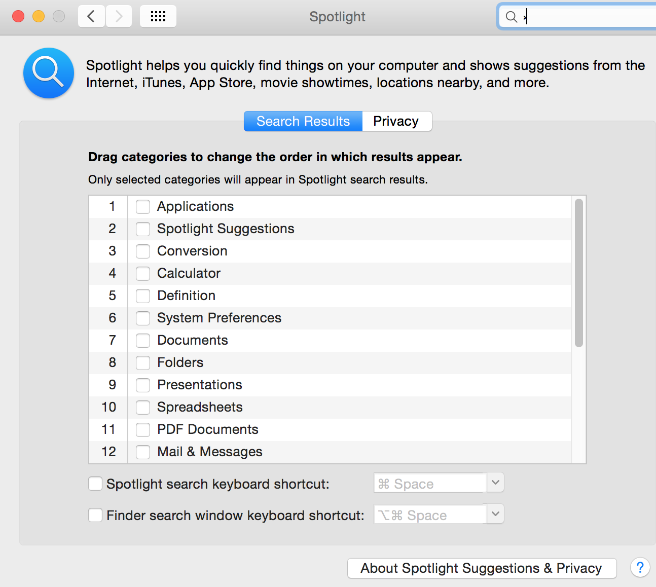

Hi.
How can I completely, fully and correctly disable Spotlight?
P.S. I do not use it and I do not need.

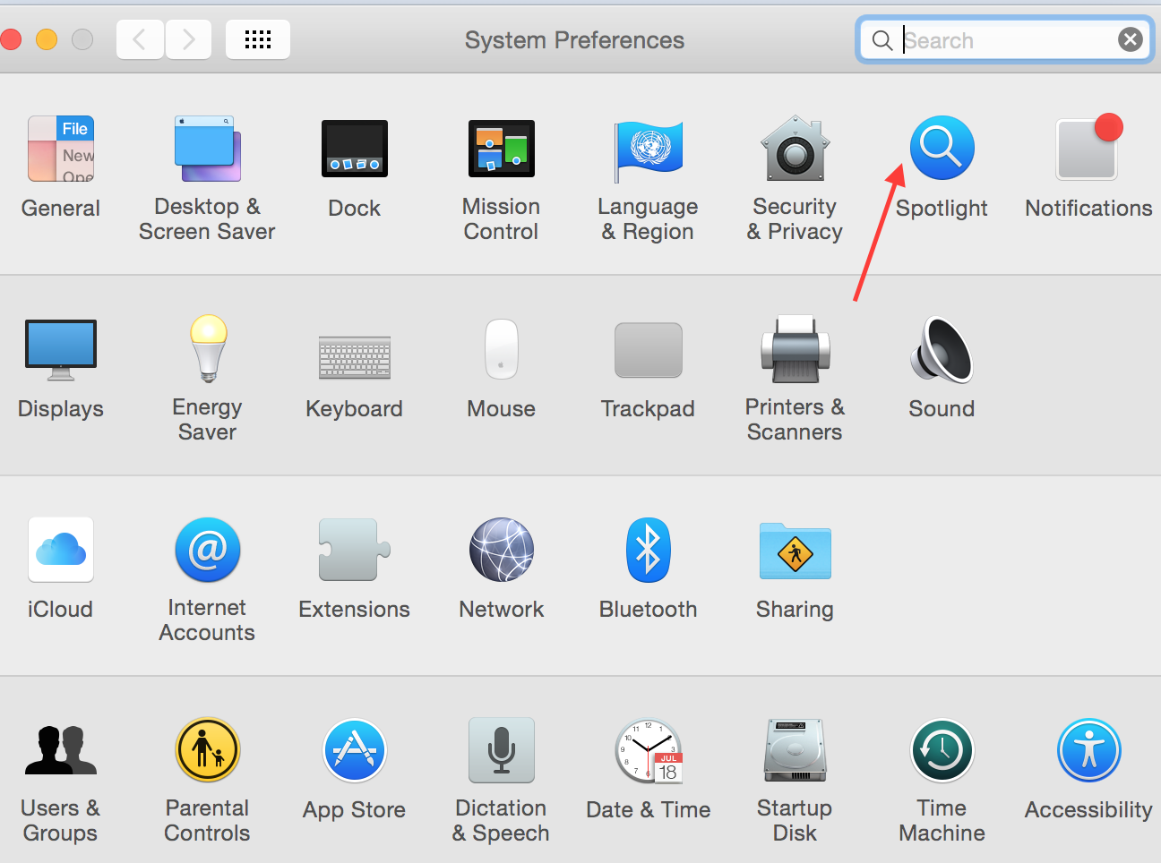

What I did was go into > System Preference > Click on Spotlight > Unchecked all the boxes.

I work very often with different USB and I can not add everyone to the list of exceptions.
Code:
sudo mdutil -a -i off
did not help.
When I insert the USB, anyway Spotlight begins to work for it.
