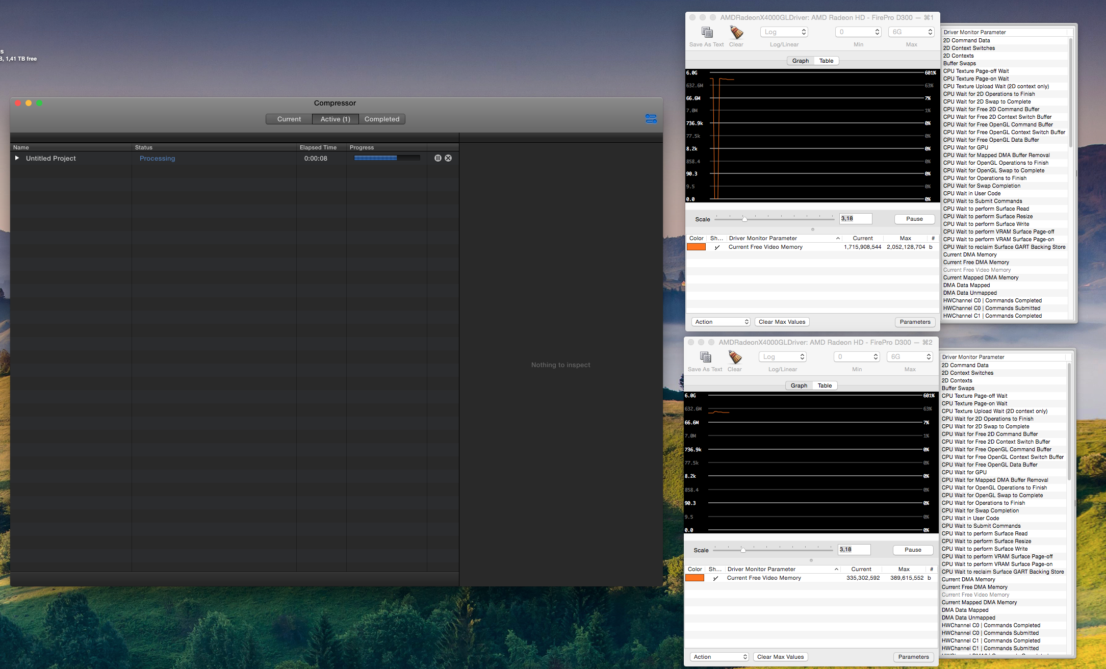

Nope, my iMac only has a single GPU and when I start crunching in Compressor (or even exporting directly from FCP X), my GPU heads up to a load of 3+ in iStatMenu.
However, I'm not sure if Compressor will use both GPUs in the nMPs.
And here is your answer :D
https://farm9.staticflickr.com/8757/17384153905_2e90ed73d2_o.png
Interesting, it's showing the video memory usage, but I think I'm reading it correctly... Only one GPU...
I don´t understand, where did you read one GPU ? There are two driver monitors open, one for GPU-1, other for GPU-2. Graph with spikes is for GPU which is computational only, and obvisusly is uses memory when its used by software. In my photo it is used by Compressor. When render finishes, all memory for that GPU becomes available again.
It looked to me by the memory usage on the graph that Compressor that only the first GPU was being utilized by Compressor in the screenshot. Sorry if I read it incorrectly, so it uses both GPUs?
Yes, when project is sent from Final Cut Pro X to Compressor. I did not tried Compressor "stand alone".
