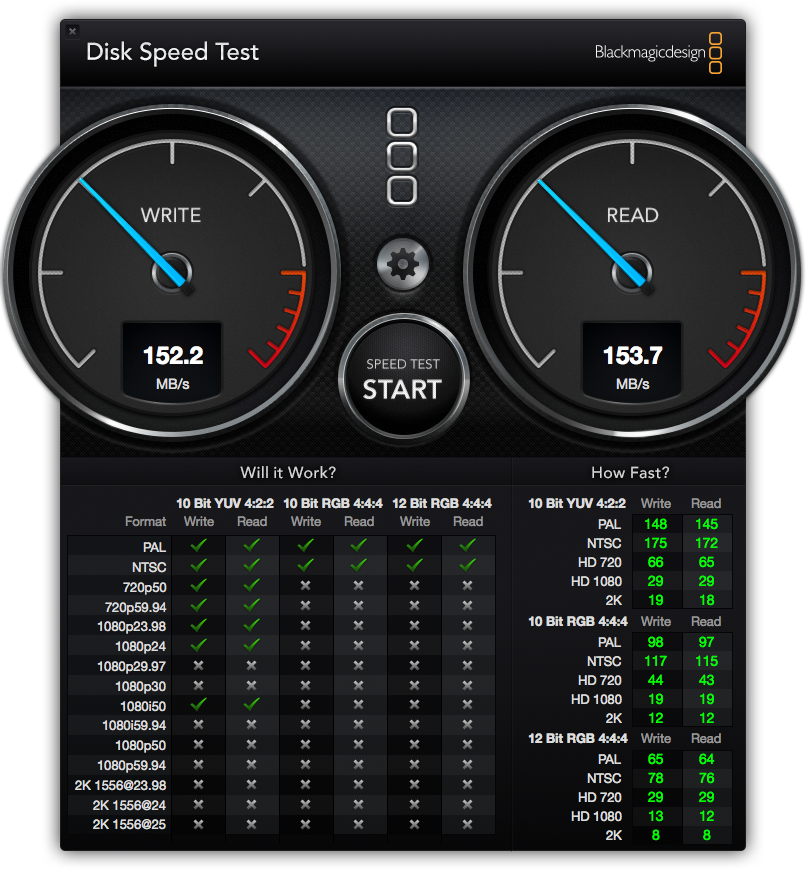

Hey thanks for the replies I will do the benchmarking later as I don't have any time now but my hard drive is split 50/50 (500gb each). Recently the boot ups got faster on mac to around 2 minutes I don't know why because I haven't been using mac at all which is extremely weird but I don't have a clue why.
Here it is:

Here it is:
Those speeds don't matter when it comes to performance sorry to say. a HD's 4k write performance aka how fast it can read many small files is more important. This test is basically showing how fast a drive can read and write 1 contiguous file which for a HD takes little work as the head is moving sequentially and not all over the place. It takes time for HD to move it's head to find a small file where as the SSD finds it almost instantly.
