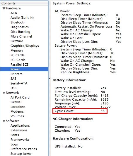

The battery is most likely completely depleted of its original charge. You can use System Profiler to see the current cycles and battery health (capacity).
from http://support.apple.com/kb/HT1519

Here's the information from the system profiler. If it was the battery, wouldn't it have to be mostly uncharged for it to turn off? I know that my battery doesn't hold as much charge as it used to, but when my computer doesn't shut down when I unplug it I do have about a half an hour before I have to plug it in again. I do think that the actual charger sits a little loose, I've been wondering if that's why it's been turning off when the adapter appears plugged in.
System Power Settings:
AC Power:
System Sleep Timer (Minutes): 0
Disk Sleep Timer (Minutes): 10
Display Sleep Timer (Minutes): 20
Dynamic Power Step: No
Reduce Processor Speed: No
Automatic Restart On Power Loss: No
Wake On AC Change: No
Wake On Clamshell Open: Yes
Wake On LAN: Yes
Wake On Modem Ring: Yes
Display Sleep Uses Dim: Yes
Battery Power:
System Sleep Timer (Minutes): 5
Display Sleep Timer (Minutes): 1
Reduce Processor Speed: Yes
Wake On Modem Ring: No
Reduce Brightness: Yes
Battery Information:
Battery Installed: Yes
First low level warning: No
Full Charge Capacity (mAh): 1124
Remaining Capacity (mAh): 1089
Amperage (mA): 0
Voltage (mV): 16564
Cycle Count: 267
AC Charger Information:
AC Charger (Watts): 0
Connected: Yes
Charging: No
Hardware Configuration:
Clamshell Closed: No
UPS Installed: No
