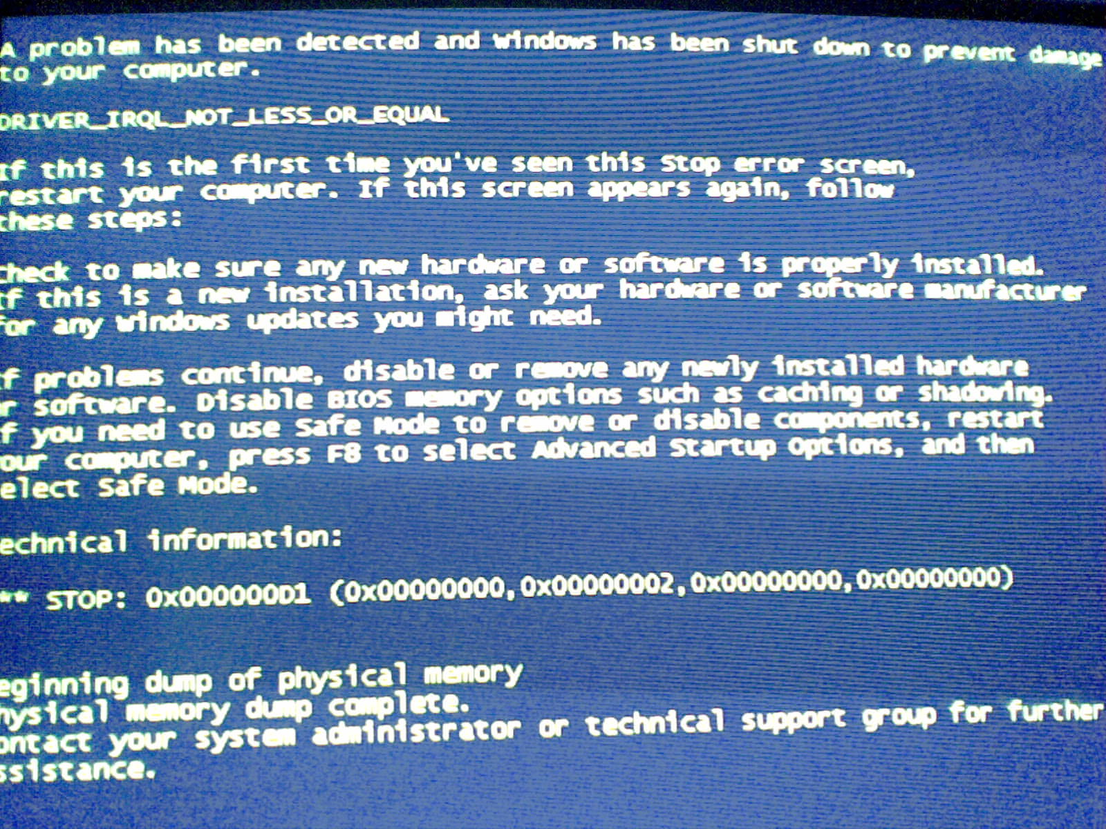

Hi guys
I need help cuz my computer reboots while i play online game
It shows a blue screen for a second and it reboot,it is impossible to read
I go to My Computer/Properties/Advanced/Startup adn Recovery/and uncheck automatically restart
And when i saw the blue screen say like this:
A problem has detected and windows has been shut down to prevent damages to you computer
If this the first time you've seen this Stop error screen(not my first time)
,restart your computer.If this screen appears again,follow these steps:
Check to make sure any new hardware or software is properly installed(I check)
If this is a new installation,ask your hardware or software manifacture for any windows updates you might need.
If problem continue,disable or remove any installed hardware or software(ia havent installed any).Disable BIOS memory options such as chasing or shadowing.
If you need to use Safe Mode to remove or disable components,restart your computer,pres F8 to select Advanced Startup Options,and then select Safe Mode.
Technical Information:
**STOP: 0x000000D1 (0x0000000,0x00000002,0x00000000,0x00000000)
Beggining dump of physical memory
Physical memory dump complete
Contact your system administrator or technical support group for further assistance.
Sorry if i couldnt insert an image but i can Print Screen when it shows blue scren,my only choise is to restart my computer.
Sry about my bad english

geekstogo.com said:
Stop 0x000000D1 or DRIVER_IRQL_NOT_LESS_OR_EQUAL
The Stop 0xD1 messages indicates that the system attempted to access pageable memory using a kernel process IRQL that was too high. Drivers that have used improper addresses typically cause this error.
Possible Resolutions:
• Stop 0xD1 messages can occur after installing faulty drivers or system services. If a driver is listed by name, disable, remove, or roll back that driver to confirm that this resolves the error. If so, contact the manufacturer about a possible update. Using updated software is especially important for backup programs, multimedia applications, antivirus scanners, DVD playback, and CD mastering tools.
http://www.geekstogo.com/forum/Windows-XP-Blue-Screen-Death-STOP-Codes-t43519.html
As the text I quoted says, this is caused by a bad device driver. If you can boot into Safe Mode, see if you can find the offending program/driver and roll it back to before the problem occurred, or update it.
