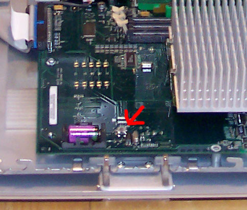

Before you start replacing parts, there are other troubleshooting measures to perform. A corrupted Power Management Unit could certainly cause the problems you describe. Resetting the PMU is easy, just a matter of pressing a surface mount button on the logicboard.

This is accomplished by pressing the CUDA switch right? Will this switch be clearly visible?

I got this document from apples site. http://docs.info.apple.com/article.html?artnum=95037 Be sure not to press the PMU twice or your computer may never work again. The button itself is very small. Look for a metal block on the motherboard that is about 1/4 inch by 1/4 inch this should be your PMU. If your model is a digital audio G4, I'm guessing because of the 40GB hard drive, the PMU switch is located near your battery.
