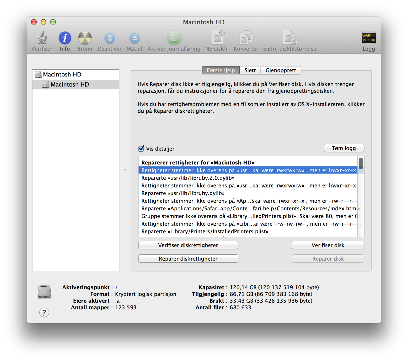

I've performed the scans as you said.
Disk verification showed these two green messages (rough translation):
"The volume 6A49CFCB-28DC-4883-9A04-D0DBE8E91805 appears to be okay."
"The volume Macintosh HD appears to be fine."
This was a great result, however the Permission reparation was a little less optimistic. 😕
The list of permissions that had to be repaired is this long:
Please let me know if this is normal or not, and what I should do. Thank you.
PS: Then I'm uninstalling Memory Clean.
The most important is getting "green" messages when verifying the disk.
The long permissions repair list in not a problem : do the repair if not already done, then restart and test the machine.

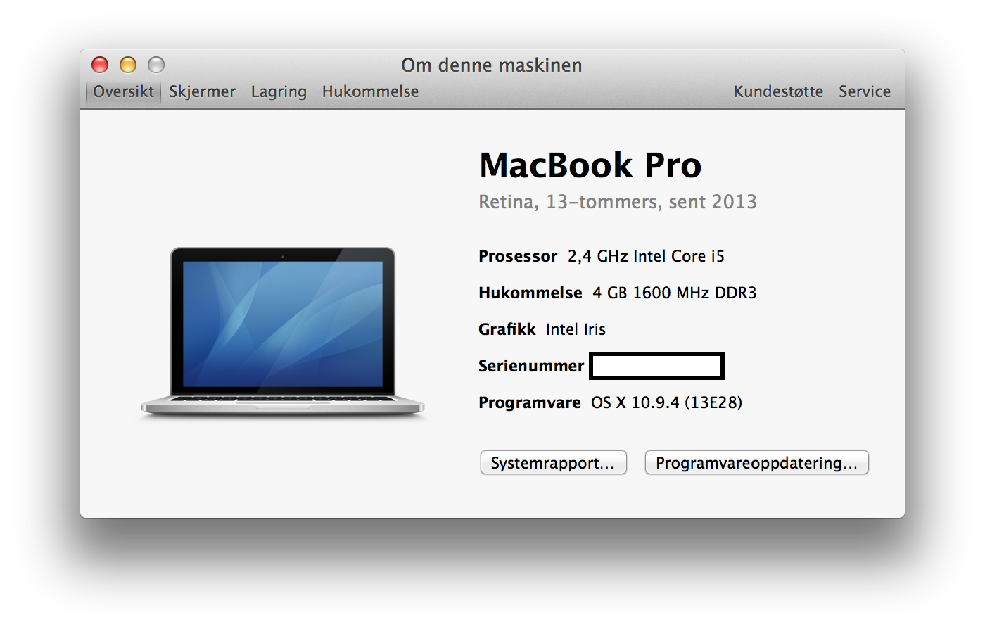

System info:

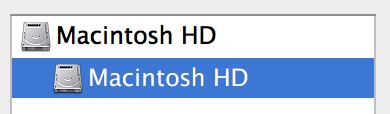

This is quite interesting because when I click the Macintosh HD at the top, it says:
Total: 120,47 GB
Available: 16,8 MB
Used: 120,46 GB
… but when I choose the Macintosh HD below, it says:
Total: 120,14 GB
Available: 86,59 GB
Used: 33,55 GB
This is the menu:
That is normal :
Macintosh HD on the top is the (physical) disk itself.
It holds your "Macintosh HD" (logical) partition.
Since you only have one partition, it uses the whole space : ~100%
Your Macintosh HD partition is 120.14 GB in size, with only 33.54 GB used (OS + Apps + data).
----> all is ok.
