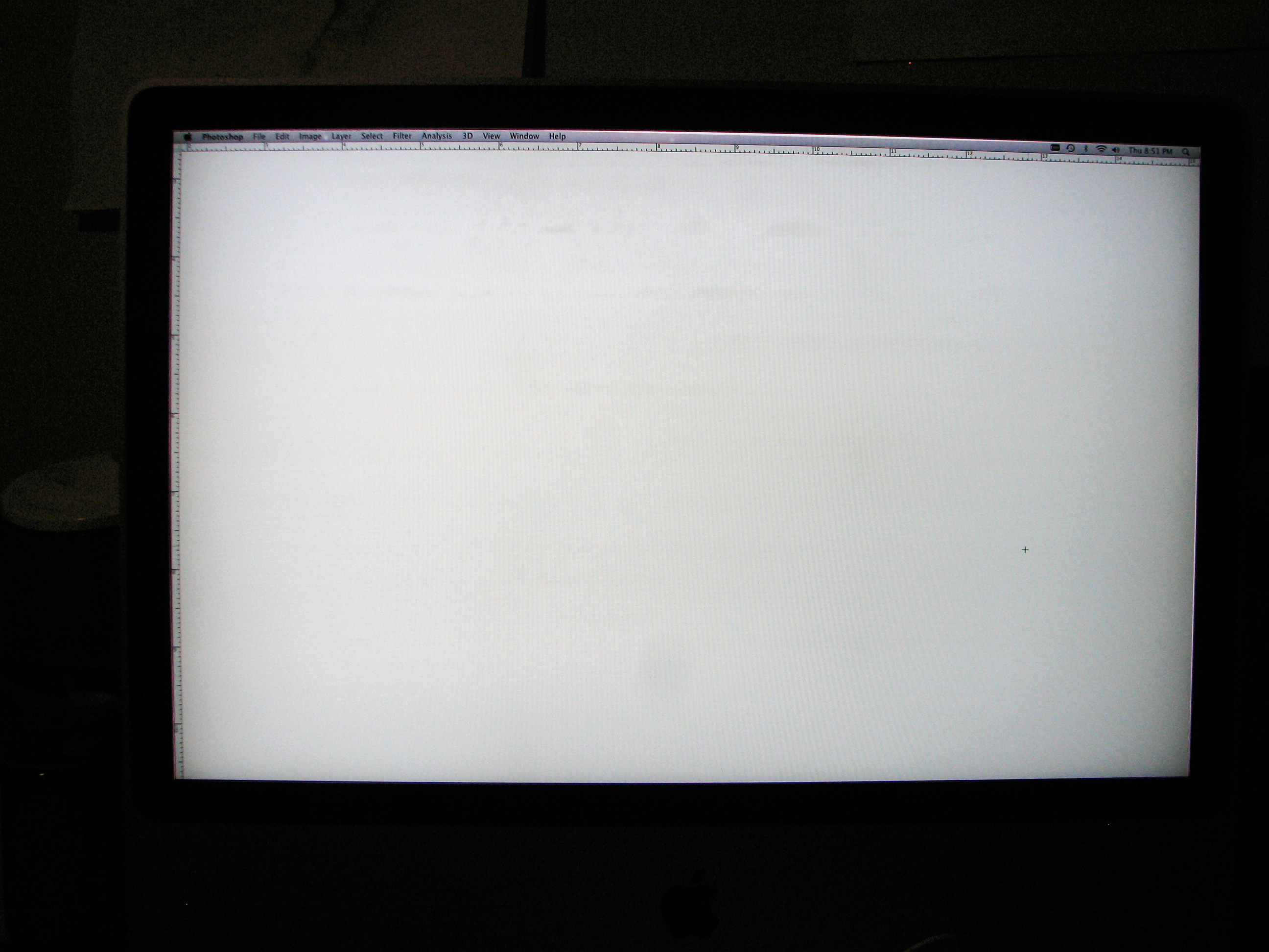

A few weeks back I noticed some cloud-like marks on the screen. I tried to wipe them away with my thumb, but quickly realized they are behind the screen.
I will upload a photo which clearly show these bands when I am home this evening. They are situated in the top-half of the screen and range in width from an inch to probably 18 inches...

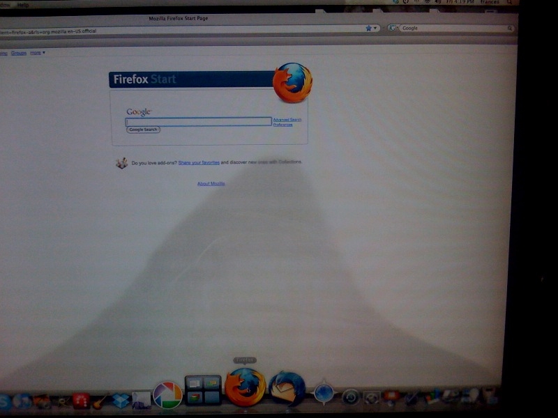

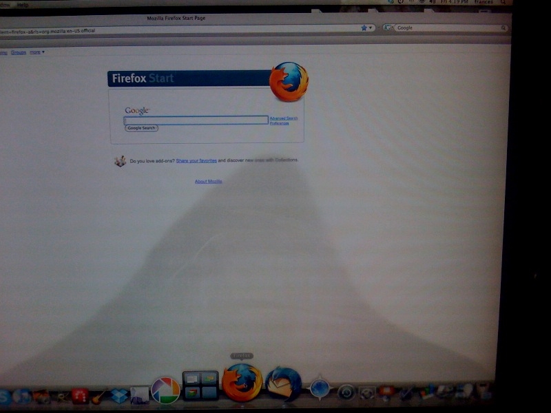

Here is a pic of the condensation on my 24" 2.8Ghz IMAC
It's about as real as it gets. BTW, we have 3 other IMACs in similar environment that have not had this issue.
