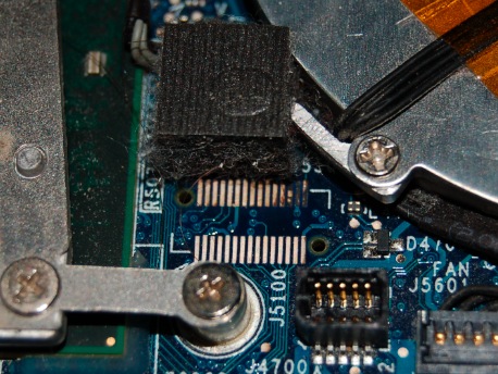

This is a picture of a part of the mainboard. It was completely dry, but I noticed some discoloration around an area that I don't believe is involved with the keyboard. Is this normal?

Well the keyboard was totally dead, even after I took it out to dry for 12 hours or so. I got the replacement today and installed it without a problem. When I took apart the keyboard and top case assembly, I noticed water damage near the keyboard and trackpad controller... I thought the problem was in the keys.
Anyway just adding to the archive of knowledge.
