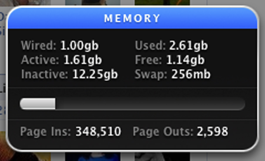

Install iStat monitor on your dashboard and run it for a week, or just check your page in/outs in the activity monitor.
If you get Page Outs, you need more ram. Here's my current in/outs for the last 3 days of uptime. This is from a Macbook Pro with 8 gigs of ram, and heavy hi-res photoshop and indesign usage:
Last time I did an export of about 900 photos in Lightroom with 4GB of RAM it took about 2 hours; when I upgraded it to 8GB my time was cut down to 45 minutes. Aparently Lightroom used about 3.5GB for the export. So I think the additional RAM helps a lot (FYI this import was done on a MacBook Pro, so it's probably faster and less obvious on my Mac Pro).
The moment you run out of ram, its like going from a 200mph bullet train, to a 20mph bicycle, instantly.
So always max out your budget on RAM, but I'd recommend getting a SSD as soon as you have enough ram. All you need to do is monitor your page outs for 1 day of work to see where you are at on RAM. With 8gigs of ram, I can't get any Page Outs with the work I do, so money would be better spend on an SSD.
But, if I was getting a 30:1 ratio or more of ins/outs, I'd go for more ram.

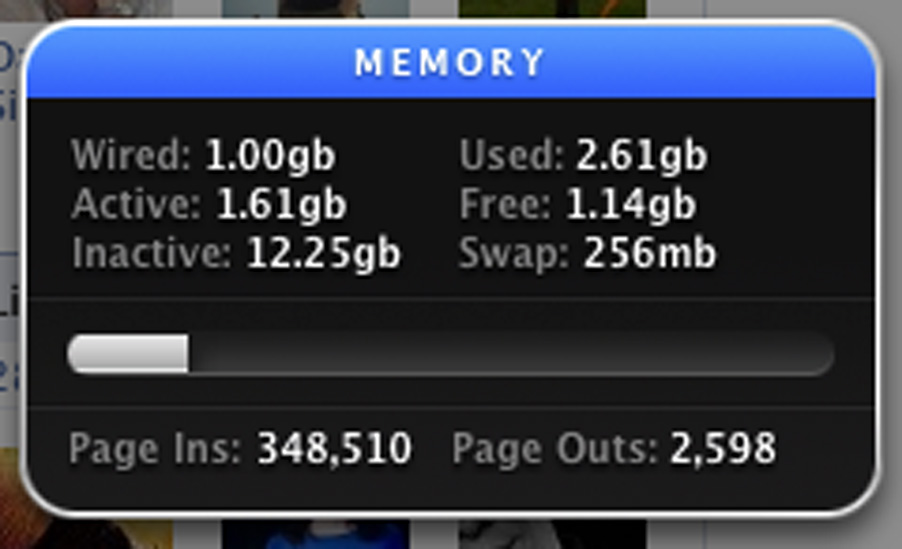

So I ordered 12 gb of RAM and was sent 16gb free upgrade, why am I getting so many page outs? It seems to be google chrome starts it off. I know I can tell PS how much RAM to use can I tell other apps too or do they work it out for themselves?
