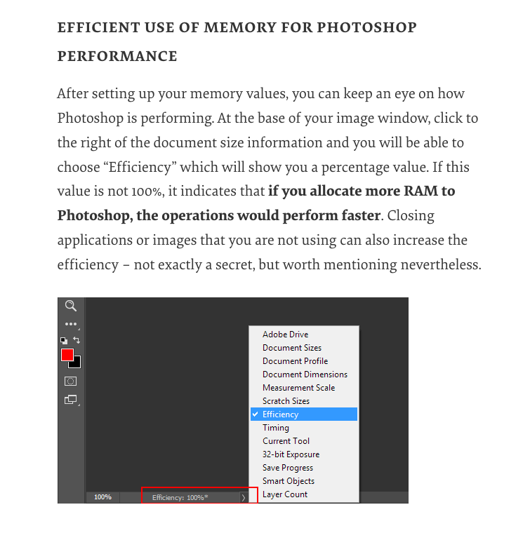

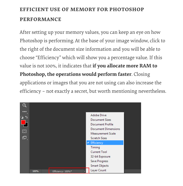

Photoshop has a ram meter thing ! idk why most people dont seem to know about it
