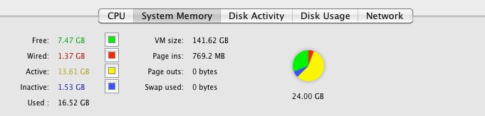

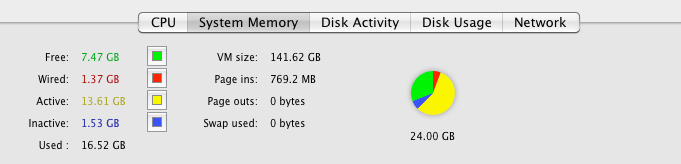

show me a snapshot of your memory using activity monitor using 8 gigs while working on say a 500 meg file !
here is mine from a 300 meg file
attachment.php
a lot of my files at 180 megs tap out 14 or more gigs all the time when doing stuff 🙂
