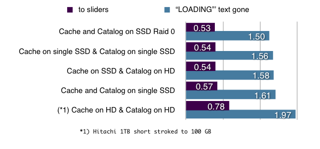

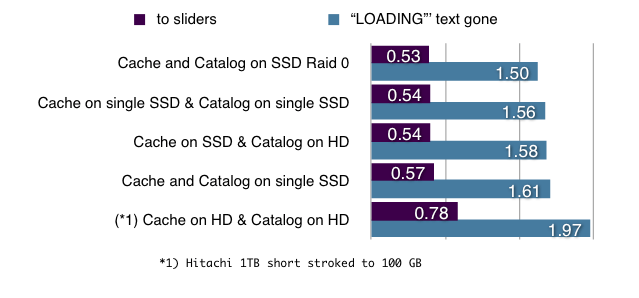

so far to me it is proving to be a bit quicker in real world as a cache drive for Lightroom
using LR seeing about %50 gains in getting the sliders ready to work but this is more a seek issue I feel since its reading the cache not writing
LR has been tougher to test ? I did some by taking video and then look at the time code to determine when sliders are coming in to view

just good info for ya nanofrog the LR cache is a cache it writes the files out about half the size of a raw file so 5d files in the cache are about 6-7 megs and thats it sits till its needed and read no more writing back
the write takes place when you tell it to build previews usually on import and its all based on how big it is ? so their is some write as you ad more images and depending on the size how it flushes but really very very very low write issues
now the LR catalog has lots of writes both to a database so very small hits and larger hits of 700KB to 4 megs or so depending on preview sizes selected
this is also why I have been keeping my catalogs on my raid and it seems to offer the same performance
the cache when set in LR is set to the size you want and once it fills it just purges out older files and stays at that size unlike PS which you have no control over ?
so its easy to say get a 40 gig and tell it 30 gigs for cache
those looking at LR cache I posted a graph I did a bunch of timing tests and raid 0 or a single about .01 seconds difference ? so to me the raid 0 thing would only be used for smaller SSD to have the size you want ?

the previews are generated in batch you import your images and use a pull down to select what size during the import they are built you can build them one at a time ? but really I dont think to many do it this way ? most do it on import
you can also select build previews as a menu item ?
it really is very low priority to write it and the write speed is not at all important
but once the data is in cache LR uses that info to generate the images you work on along with your original images !
that data is used to build the images you work on so the read of that data is critical to speed of getting to work on the images
some on normal HDs have about 1-2 seconds until you can work on a image
a short stroked hitachi 1Tb to 100 gigs takes about .78 or so seconds and the SSD takes about .53 seconds but this .25 to some who are working on thousands of images it ads up quite quickly
and moving from image to image quicker also make a nicer workflow and does not break your thoughts so actual production goes way up more than the time saved !
I have noticed about a %25 time savings
a normal job is about 5 hours now about 4 hours
so those who work in LR have to decide if that time will make up for it ?
I would say the time and cost is easy if you work with LR for a living as a photographer its worth it
if its a hobby ? raid 0 short stroked seutps are not bad
this is the timing chart I came up with over a few days of testing
and this for LR users is about how quickly the white sliders come in to view in Dev mode !

I am never the smartest man at the table 🙂 but I usually am pretty good about only commenting when I know 🙂 and will admit when I am wrong 🙂
remember PS hits the scratch a lot and keeps it optimized as you are working ? so a dedicated scratch is always always best !
curious where is your scratch pointed to ? 🙂
top slice partition of my raid 6 array
the Schewe thing are you sure he did not mean they cant write so they have to go back and forth ? meaning dont put a file and scratch on the same disks if you can ? or it will get fraged and become slow ! I am willing to bet on this over the other 🙂
Hi, i've finally found the link that i'd archived, but i'm getting a 404 when clicking on it - i guess that adobe have changed their forum addresses since august 2007.
Anyhow, i'm sure it's as i remember (that PS will not write a file to disc at the same time as accessing the scratch). Reasons:
The OP's problem is that he can't do anything else while PS is saving his file. Looking at iStat while my large file is saving, there is virtually no 'read' going on (a couple of bytes at the end). The time i gave above was for a newly opened file (ie has no history states). At 400Mb/s write speed, the file of 1.9Tb should only take around 5 seconds to actually write (but not generate).
All of this seems to me to point that it won't access scratch while writing the file ... i could see the argument that it will do this as it is "generating a full resolution composite" or other parts of the process, but it seems to me that the actual file (i was saving) is largely written to disc in a matter of seconds towards the end of the process.
Cheers
I hear ya on the writing at the last moment and using the scratch in theory it might work ? might be the way it is ? dont know so wont say cause that would be wrong 🙂
so might be true ? not doubting you 🙂
in reality in the past I have found it quite dif I used to make a living doing arch interior work so HUGE files
and in testing writing to scratch on same disc as files turned against me with longer times !
this I do know and what I am going off also my own times for similar file sizes
for grins what happens when you point your scratch toward a un used disc ? like a BU or something ?
also the 1.9 is that on the disk ? meaning you hit the get info or see it in finder as 1.9
I have a image that is set to 300 dpi print 36 inches wide about 8 layers ?
its 1.95 GB on disk I do not check the maximize on close ! since I am the only one opening these 🙂
once you hit the button takes 2-3 seconds for the saving to pop up ? but the timing is showing 16.4 (16.5 saved again as a new file new name etc.. and 16.6 a third time) for me to save that file to my raid ?
areca 1222x with battery module
both are raid cards are IOP 348 basically the same setup
I have slower HDs than you but you have one less HDD ? not sure how that balances out but very close systems
I have a 3,1 with 14 gigs my OS is SL boot in 64 using CS5 running in 64
my scratch is pointed to the SSD ? that might go back to a raid 0 short stroked setup ? still testing
but if I point my scratch to my raid the times go up to about 18-19 seconds ? not a huge difference
even a 5.5 GB image on disc is less than 2 minutes for me ?
this of course is a PSB not a PSD 🙂
