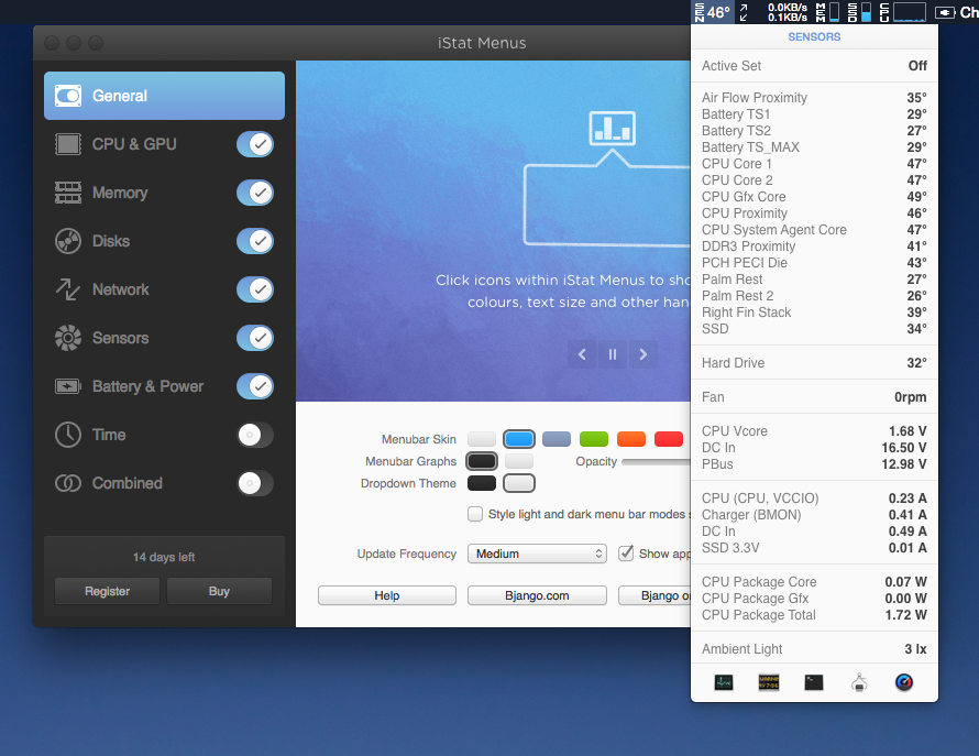

ok installed istat to triple check
looks like the original system analysis software I used was accurate;

I love this, its like having the totally silent operation of the RMB but with extra power under the hood - fan noise has annoyed me for years
