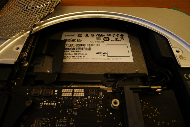

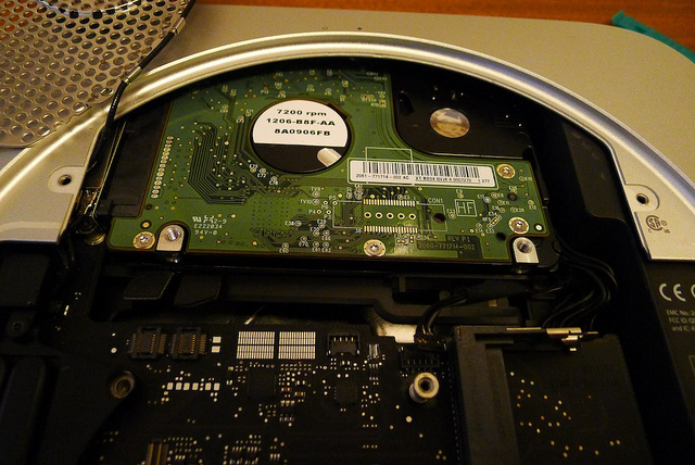

I went ahead and attempted to add a 500GB 7200RPM WD Scorpio (Black) to the second, unoccupied port on my 2.5Ghz Discreet i5. I'm pleased to report that it is possible to add a second hard drive to your non-server (2011) Mac Minis. Many thanks to saulinpa for pointing out the appropriate part number from the 2010 server model!
For anyone who's familiar with the 2011 mini teardown, this install should only take about 15 minutes, view instructions on the teardown at iFixit, also further notes on an SSD upgrade.
Otherwise, the process was as follows, apologies for the dark photography, I didn't feel like post-processing photos today... (*IMPORTANT* footnotes at the end):
Disclaimer: this upgrade will most-likely void the manufacturer warranty on your mini as going beyond upgrading RAM is not recommended/supported by Apple documentation. Complete this at your own risk. (7/31/11)

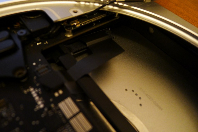

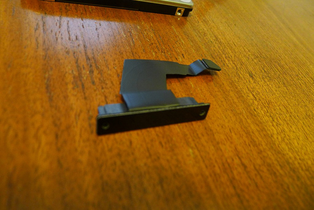

  • I ordered the "Bottom Hard Drive Flex Cable" (part: 922-9560) from macpartsonline.com. They have them for a steep $33 and even steeper $16 shipping charge. Hopefully iFixit or another company will be able to manufacture/reproduce the part for significantly cheaper. Otherwise, shipping was speedy (it made it from LA to NYC in 2 days)

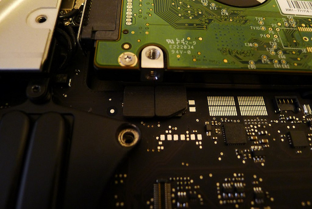

  • Testing out whether the cable fits, and it does! Then fitting the cable and my SSD into the extra port. It might be a little difficult to make out, but you can see in the second photo that the new cable matches up nicely to the second SATA port.
  • Adding the new hard drive and snapping in the cables. Nice!!

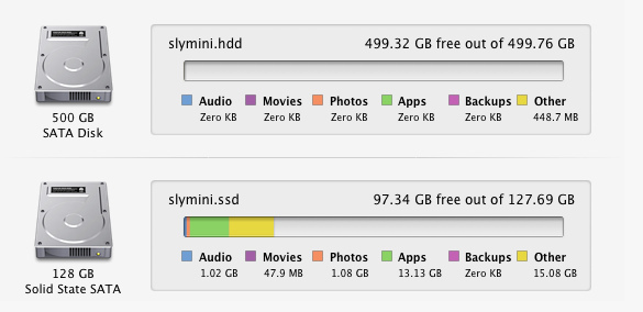

  • Started up, and my mini is 500GB healthier!
Important Footnotes: I did make a couple faults, nothing major, and definitely/likely a reflection of my overeagerness and intermediate level of computer knowledge, but definitely for your consideration.
  1. During the teardown, you'll need to slide the motherboard out of the case at least 1/2 inch. The iFixit teardown demonstrates this, though they neglect to mention that you should remove the motherboard mounting screw underneath the fan. I also suggest that you disconnect the power supply cable on the right of motherboard, just behind the RAM slots.
  2. DO NOT SWITCH YOUR ORIGINAL HARD DRIVE TO THE SECOND PORT: I had neglected to buy Hard Drive mounting screws for the new HDD, and figuring that the SSD doesn't require as secure a seating, I decided to transfer the existing mounting screws. Ultimately, this made me believe that the original drive (the SSD with Lion installed) would work perfectly fine in the additional port. WRONG! Booting up after the first upgrade attempt, the mini took about 30 extra seconds searching for the bootable drive, then was excruciatingly slow starting various applications. I tried setting the "Startup Disk" in System Preferences to no avail. So I ended up having to do the upgrade all over, moving the SSD back to the original port. After I did this, the mini was back to its speedy self!
  3. If you decide to seat the original HDD/SSD in the additional SATA port, a fresh Lion re-install will likely be required.
  4. Luckily, the mounting screws on the HDD fit perfectly into the mounting holes for the extra drive. I'll go ahead and get another set of mounting screws soon.
  5. I have a Crucial M4 SSD, which is physically larger than the HDD, which makes for a very tight fit if the SSD is going to be seated in the original port. Be sure to check the drive's cable's connection before you close the mac mini back up!
That's about it for me. This write seriously took 3-4 times as long as the upgrade. Hopefully we'll see more mini owners taking advantage of that second port. Such a money saver and an elegant solution if you have the resourcefulness!

Wow this is great info. I upgraded my 500gb 5400 rpm drive with a OWC Mercury Extreme 240gb SSD drive and thought I had accomplished a lot.
It is great that you found out the right cable. I may just put this 500gb 7200 rpm drive I have in as my second one.

[*] DO NOT SWITCH YOUR ORIGINAL HARD DRIVE TO THE SECOND PORT: I had neglected to buy Hard Drive mounting screws for the new HDD, and figuring that the SSD doesn't require as secure a seating, I decided to transfer the existing mounting screws.
Do you happen to know what size mounting screws Apple uses on the 2011 mini? During the time it takes my new SSD to ship, I figure I can go out & pick up a few.

Thanks so much for the post. I just ordered a base to use as a media server. One question I have though is related to the HDD installation. Is there a bracket that the HDDs are attached to? It looks like they just sit on top of each other but I can't figure out how they are stabilized. Thanks.
slyseekr
macrumors member
Jul 6, 2010
37
Brooklyn, NY

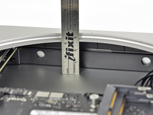

Each drive has dedicated mount on the case-side of the drive. The only mounting hardware you'll need are the hard drive mounting screws, and only two are required per drive, for the mount-side.
Otherwise, there isn't another mounting bracket that I'm aware of (it honestly appears that apple is using the SATA cables to keep the drives in place).
You can see the bottom drive's mount in this iFixit photo:
lR1QgnCGH5qWSqVW.medium
Good luck!

Does it appear that you could cram 2 x 12.5mm drives in there?or at the very least a 12.5mm and a 9.5mm. I would like to get a 1tb drive for that second bay....

I have a 256 GB Crucial SSD i picked up and i just ordered the cable. any idea what screws i'll need to mount the drive?
RUSTYC
macrumors newbie
Jul 23, 2011
7
I just did this too with a 120GB SSD. The screws are M3x4 socket head cap machine screws.
The SSD sits loosely in the bottom bay. The screws just keep the drive from falling out of the plastic carrier. So I think any M3x4 flat head screws would work.
I used small pieces of mounting tape on the top and bottom corners of the SSD to keep it from moving around.
My system is running from the SSD with the original drive used for media files.
Took 3 days to get the cable from mac parts.

The pic above suggests 26mm, so 12.5mm x2 should be possible in theory. Sure I read somewhere that there are now 9.5mm 1TB drives though.
Can anyone confirm the size of the primary harddrive? Does it need to be 9.5mm or can it be 12.5 mm
It sounds like the location of the primary and secondary drive also matters.
I'm hoping I can get a little help here with a phased upgrade
I would like to put in a larger harddrive than the standard 500GB primary drive. I'd prefer the put in a 1TB drive now, and move that to the secondary drive next year when I'll put in a SSD as the primary.
Do I need to worry about height of each of these drives as I plan for the future? I wasn't even aware of this dimensional restriction until this thread.
Thanks for your help

I'm debating whether to attempt this or just buy the BTO. Some dumb questions...
If I choose the Samsung 470 SSD, hopefully I won't need to need to move the logic board to install, only the fan and grill?
Does it matter whether I stick the SSD on the bottom and the stock ATA drive on top, or vice-versa?
After I use the internet recovery to install Lion on the SSD, should I keep everything installed on the stock ATA in case I need to return the machine to Apple? I assume this procedure doesn't void the warranty or AppleCare?
I'd only save about $99 over the BTO?
Samsung 470 256GB- $420
iFixit Security Bit Set - $32
Bottom Hard Drive Flex Cable - $49
Total - $501 versus $600 for the BTO.

Bear in mind the SSD that Apple provides in their BTO systems is a SATA II which is 3GB/s. I don't know what the Samsung is that you're referring to but if it's a SATA III then it will run at 6GB/s. The Mac Mini does support SATA III drives so obviously Apple is cutting costs by including a SATA II SSD but still charging more for it then if bought after the fact and user installed. The fact that the included SSD is SATA II what put me off more then the extra cost.

I probably should put a disclaimer that going beyond upgrading the RAM in your mini will likely void your warranty.
This is a complete-at-your-own-risk procedure.
Key word here is 'likely'. this is not proven. I'm pretty sure Apple has been lenient on owner installed hard drive upgrades on previous Minis. I do not think there is substantial proof otherwise. I can see if they try to prove that your hard drive fried your motherboard. But since Apple is offering dual large, faster drives themselves they can't say the Mini can't handle drive upgrades. I guess you take your chances tho with Apple. hmm.
Voiding is definitely the "default" state, but of course the Geniuses behind the counter generally have some degree to exercise their own discretion. I (and my friends) have had my own measure of luck when meeting with them over various issues in the past. ;)
