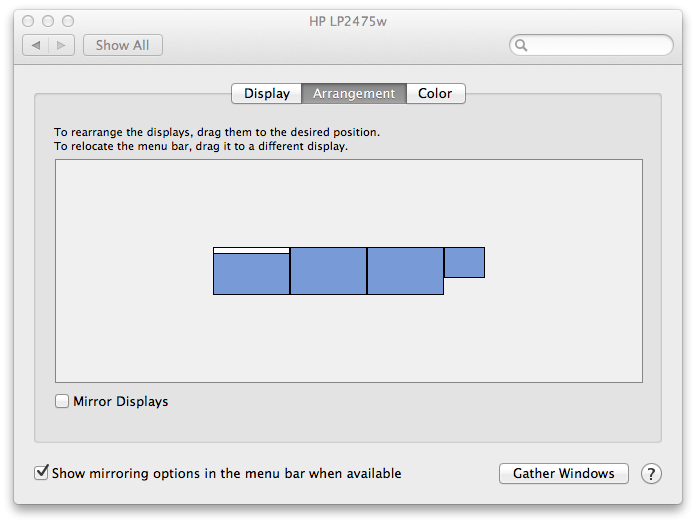

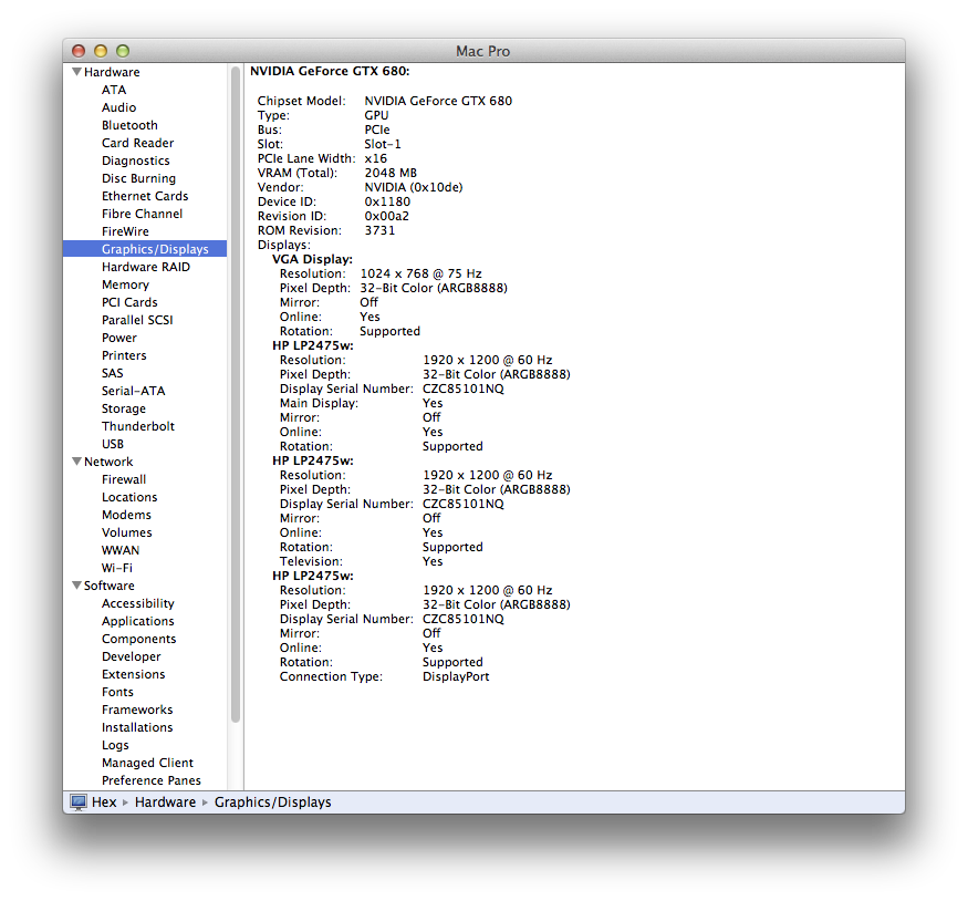

Two questions
Do all of the output ports work on a flashed 680? At a minimum I will need both of the DVI ports to work.
The MSI and PNY reference cards seem to be less expensive (10% less) than the EVGA reference cards that everyone seems to prefer. Is there a difference? I'm not seeing it.
Here you go...
DVI, HDMI and DisplayPort connected to a 24" HP monitor and DVI connected to a projector via a DVI/VGA adapter.
