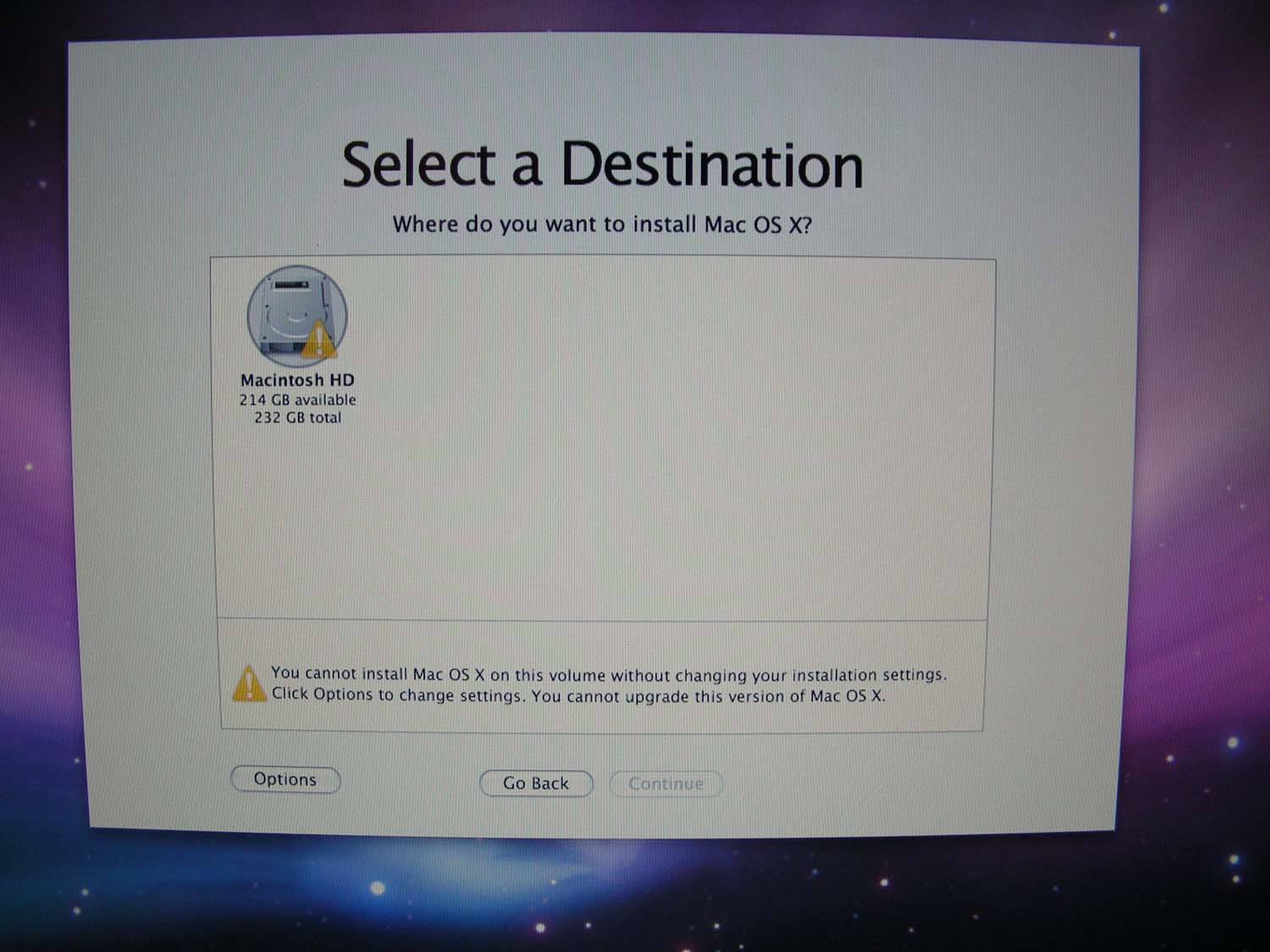

I just got my new MBP and was attempting to reinstall Leopard. (10.5.2 is on my computer as well as the discs that were shipped with it.) When attempting to reinstall at the part just after I select the hard drive I get this message: "...You cannot upgrade this version of Mac OS X." Is this normal? What is that message supposed to mean? Certainly I can upgrade to a future version even if I choose to reinstall the current version at the moment? I called AppleCare and the lady I talked to seemed stumped as well. At least she admitted she had never heard of it. Any suggestions? I'm afraid to go through with a reinstall at the moment. Does the message simply mean more specifically "There is no upgrade available at the moment because I have the latest version"?
Also, on a side note, I know the OS takes up a bit of space but I ordered with the stock 250GB HDD and it says I have 214GB available out of a total of 232GB. Shouldn't the total be 250GB?
Thanks!

It means that you already have the same or newer version of OS X installed. In this case you already have 10.5 and that is what this disk has.
You can only have one OS X install per partition so if there is an existing install the install disk can only upgrade what is already there.
What you need to do:
Look in the lower left corner there and you see a button for options. Click it and choose either "Archive and install" which will save all of your data and old system to a folder before installing or "erase and install" which erases the disk and then installs a fresh copy.
Ok, thanks! As I just got it and have nothing on it, so nothing to archive and save. So I'm going to do an erase and reinstall and try to create more space like getting rid of printer drivers and extra languages, etc. Though it's still weird there seems to be a lot of space being taken up there and only 232 GB total? When the actual total should be 250GB. Don't understand that.
