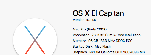

I know that according to the official Sierra compatibility the 2009 Mac Pro is not supported. However, I've read that the Mac Pro 5,1 is supported.
Looking at the specs on the screen shots below, can I or can't I upgrade?

Yes, you can. Your machine is a 2009 Mac Pro (4,1) flashed to 5,1.
Awesome, thanks. I brought this back in Feb this year as a custom build for my photography business. A friend of mine who is a lot more tech savvy than I am pretty much dictated the specs and I just paid for it. All I know is that it's ultra fast.
