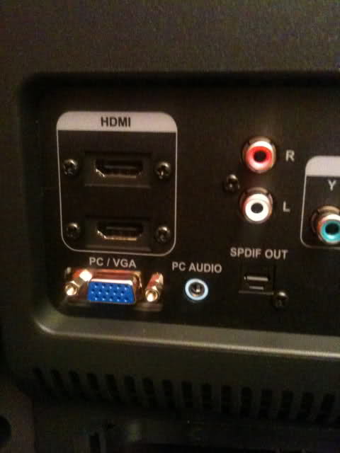

Sorry, I've searched several threads, but some have different issues or want to connect different ways.
here is a picture:
okay. I want to connect via HDMI. Do I get the Mini DisplayPort to DVI>then a DVI to HDMI cable?

I got the display to work but the audio isn't working. I don't get it.
The Mini-toslink to Toslink cable isn't working. My TV says SPDIF out... so that means that it won't be able to connect to my Macbook??

Well I already got the MiniDisplay to HDMI but I can't seem to get the Mini-toslink to Toslink cable to work. I don't know how to get the macbook to output the sound through it.

Yeah, still not working. Maybe I'm not doing something right. But I'm not sure. Maybe it's the wrong cable.

first make sure your TV has a optical/toslink IN some TVs will only have an optical OUT for a receiver speaker system.
if this is the case you may need to buy the monoprice solution and do audio through the HDMI port or use a 1/8" to RCA cable to the tv, but this will not get you surround sound, only stereo.
oh i just looked at your picture. that optical port is an optical OUT not an IN. if you dont have another spdif port then your other option for audio are the ones mentioned in my previous post.
what type of sound setup do you have? if youre just using the TV speakers then using the RCA cable would suffice. if you have a surround sound system then you want to connect the optical cable to the receiver directly.
