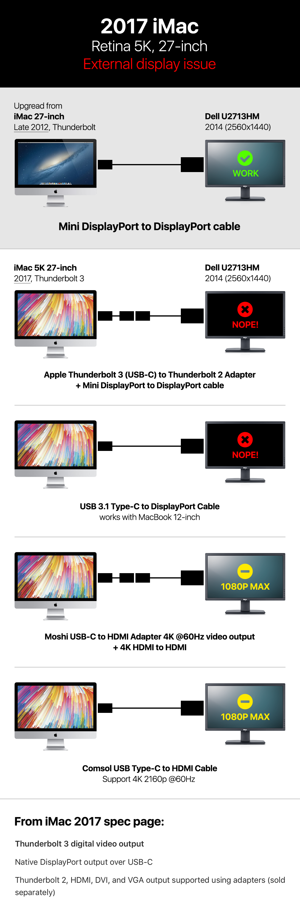

Same issue here with my 2017 iMac 27" and Dell U2713HM (27", 2014, 2560x1440). Try pretty much EVERYTHING, nothing work. See attached image for info about what I have tried. The monitor work fine with my previous late 2012 iMac 27".
It is very strange that they listed "Native DisplayPort output over USB‑C" on spec page but a simple USB-C to DisplayPort isn't working. I also try the same cable and display with 12" MacBook, work fine. All HDMI connections I tried seem to max out at 1080p.
Had a few phone calls with Apple support, they said the only option is to get a new monitor or update monitor firmware (which doesn't exist).
This is the cable that I got from eBay which doesn't work. I found this on Amazon said it support 2017 iMac/iMac Pro, not sure if this will work (I don't live in US, so can't buy it).
Also anyone know anything about USB-C Port (with DisplayPort ALT mode)? Is it required to make this work?

I tried with my Dell U2715H and iMac 27 2017 - TB3 to TB2 adapter - TB2 to Display port or TB2 to miniDisplay port - nothing. The monitor works fine with my 2013 Mac Pro. Bummer....
That's almost identical to what I tried, except I didn't have the 2 cables that gave you 1080p resolution.

BTW, nice graphic explaining what you did.
Mind if I steal it when trying to post the question on other forums ?
