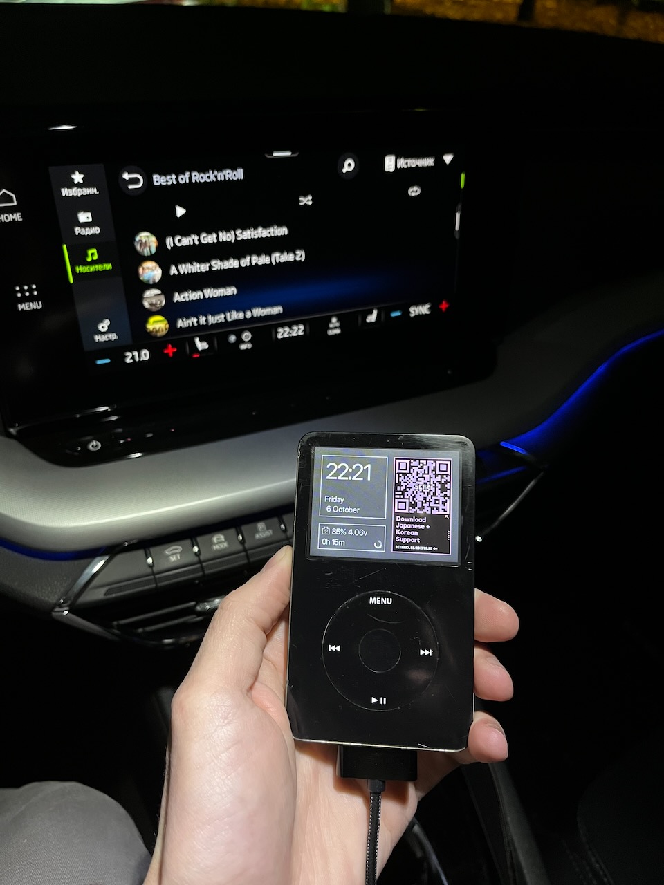

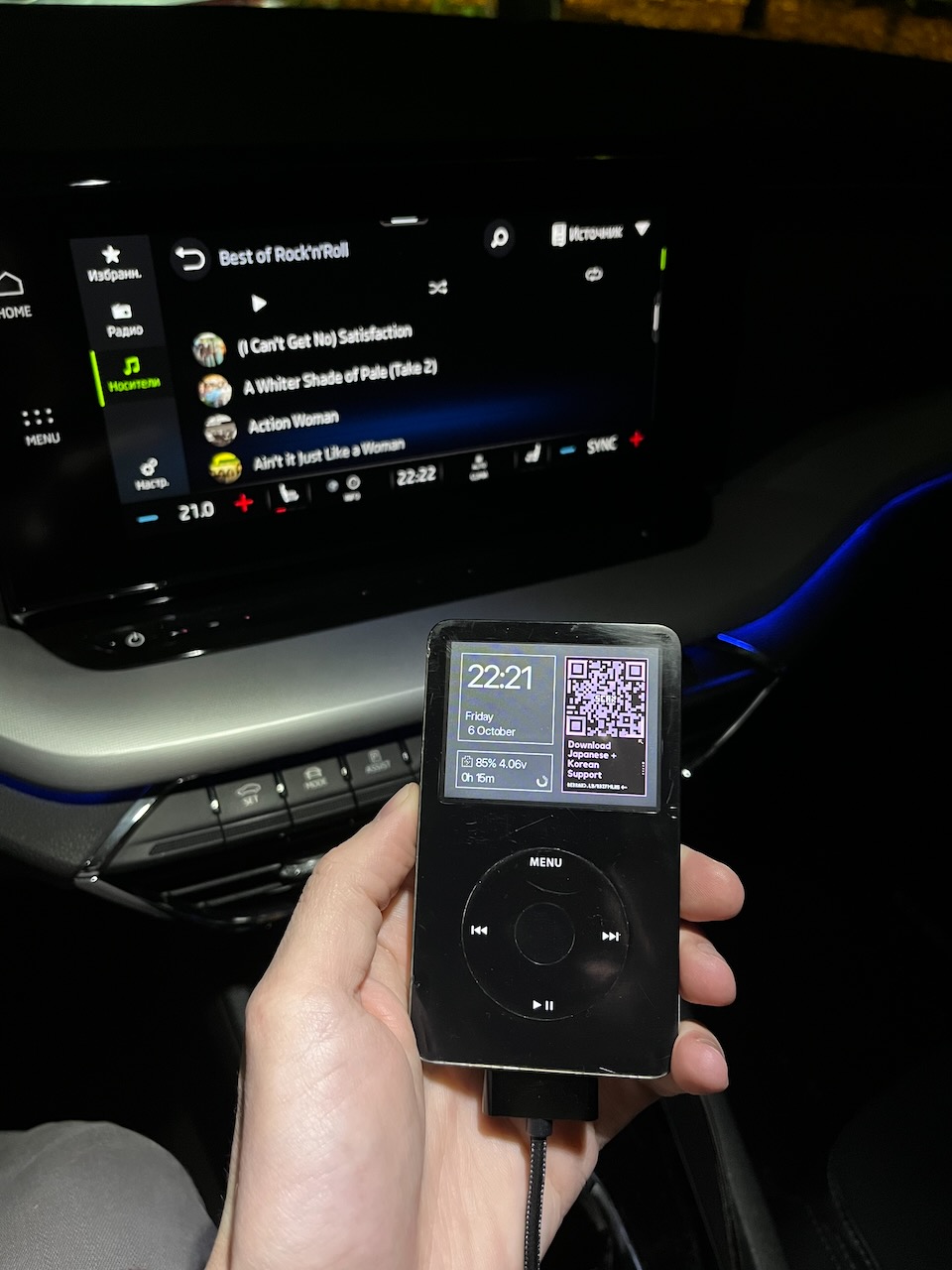

From day 1 as i've bought my *cought* first iPod Video, i've wanted to test it in my car. Will it work? So i've got a ZMI USB-USB-C adapter, basic 30PIN from PZOZ and went to do some tests. And... it works! Just deep inside the menu, where you select USB sources. Car is 2021 Skoda Octavia MK4

Reactions: Beefbowl
