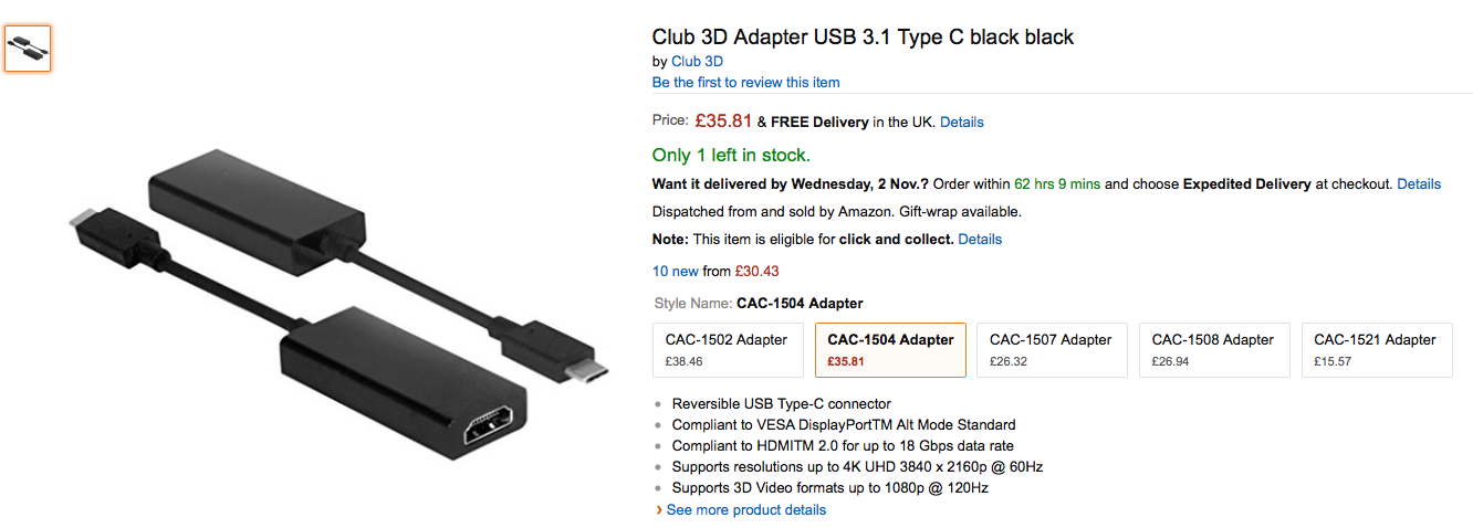

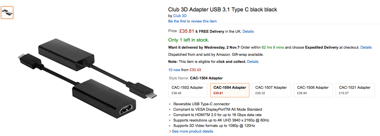

- USB-C ports can be configured in a number of ways. On all of Apple's machine's they have DisplayPort. On the new MacBook Pros they also have Thunderbolt 3.
It does mention DisplayPort on the Amazon page:
  • Compliant to VESA DisplayPortTM Alt Mode Standard
