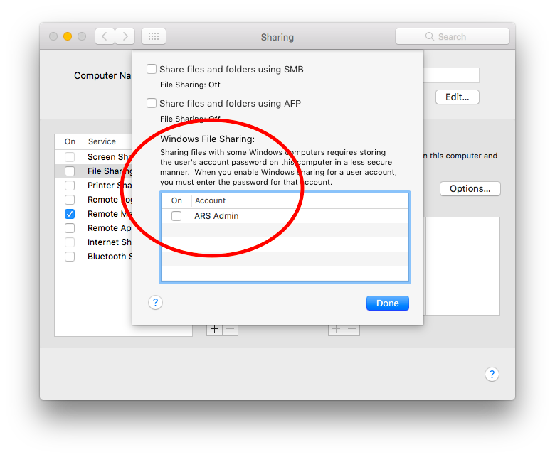

Have you enabled SMB1 / "legacy Windows sharing" in System Prefs for the user account you're trying to use to connect to the Mac? Screenshot attached; it's the lower portion of the File Sharing Options pane. I've never heard of RISC OS, but it sounds like that's potentially the issue?
