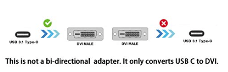

Hi all....I'm about to order the DVI-D to USB-C convertor cables. Two questions.
1. Amazon prices range from about $14 to $20. Can I go with the less expensive?
2. One cable manufacturer states this is not a bi-direcional cable, and provides this illustration. What the heck are they talking about? 😕
It means exactly what it shows in the illustration.
The cable won't work when connected to a DVI output adapting to USB-C (Computer DVI output to USB-C device)
So, USB-C to DVI device will be fine. The cable just isn't designed to provide an acceptable video signal both directions.
YOUR usage is the one that cable supports (video out (on a USB-C connector) to DVI device (which uses that DVI-D connector.) All good.
Can you go with a cheaper cable? That will vary from one setup to another. Some will be OK, some not. No way to tell (unless you see a review post that is specific to your exact setup). If the price difference was more than just $6, then it might be worth testing on your own setup (just my opinion, but whatever you find worth trying out. You may be lucky.)
DeltaMac, thanks for the explanation. My confusion (and at first when reading your reply) was that ISB-C is considered video output. Which makes sense as the Mini is sending video to the monitor. My mind was thinking (??) of a TV plugged into a cable box, where the TV is the output and cable box the input. Duh, I need more coffee! Thanks again.
