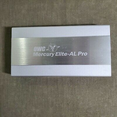

As for a Firewire, with your computer I would get one of these used from ebay if you can:
I have two 2012 Macbook Pro 13's and used that very external enclosure with firewire 800 for backups, even though the 2012 has USB3 and thunderbolt. It's convenient, it is a port I use for nothing else any more (used to use it to input video from a Sony MiniDV HD video camera). Simple to open and change the sata hard drive. Should be able to get one off of ebay for less than $40. Other World Computing often has them in their garage sale too, although not right now. https://eshop.macsales.com/shop/garage_sale
