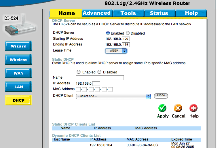

Ok, this is how far I've come.
I use 192.168.0.1 to log on to my router.
In the config module, I can choose a time frame for the lease. I can't choose unlimited, or any period of time greater than one week:
I don't know whether or not I can choose static IP addresses for our three computers, or how to do so if I can.
I don't know if I need to input the DHCP client name(s).
I have never previously needed to input my user name and password in order to get online, neither via airport or via wire, so I'm assuming that means my modem is set up for routing, not bridging. But I don't understand how to make sure my router is set up in the same way.

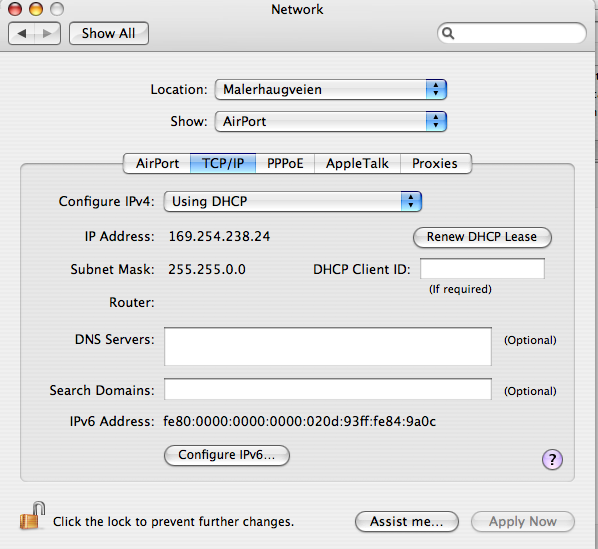

In the system prefs, I can click on Renew lease. This will sometime make a number appear there where no number was before, but doesn't seem to make a difference as far as whether or not I can get online:
Has any of this made any sense??

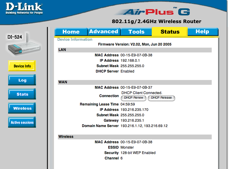

Ok, it looks like I fixed it.
Forgive the double posting, but it would've been confusing for these two posts to be combined.
I found a place in the router config where it said that DHCP was not connected. This was concerning WAN only. I clicked on the "connect" button, and shouts of joy came from my 14-yr-old son's room :D
Here's a pic of where I found this:
So, have I understood this correctly?
1 The problem is that my router will only keep a connection lease for one week. If we're gone for longer than that, this will happen again.
2 The problem above is because the router assigns random IP addresses to the computers on the network. If I were able to make the router give each computer a static IP address, this would not be a problem.
3 If I don't change anything and just live with the situation, I can always go into the router configuration each time it happens, and just have the DHCP reconnect under WAN in the attachment above.
