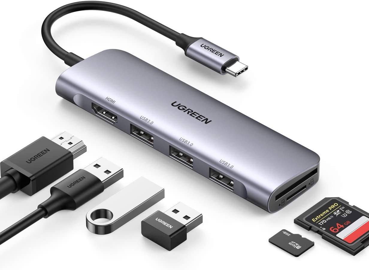

I am going to order an M1 Mac Mini 16gb/512gb and I have a question about connecting my 1920x1200 24" monitor and 1920x1080 21.5" monitor to it. The Mini has one HDMI port that I will use for the main 24" monitor. I already have this UGREEN dongle that has an HDMI port, SD/micro-SD card reader, and 3 USB-A ports. Will I be able to connect my 21.5" monitor using it?
https://www.amazon.com/UGREEN-Adapter-MacBook-Chromebook-Aluminum/dp/B07RV1ZCWJ

Well I looked it up and found this https://thesweetsetup.com/running-multiple-monitors-on-an-m1-mac-mini/
DisplayLink lets you use more than one hdmi monitor. It is often bundled with docks like the one you posted. It’s ok, not great, but definitely ok. I use a mbp 16” with open lid and two ultra wides.

That adapter is USB, not Thunderbolt. However one of the reviews specifically mentions it works with the M1 Mac mini using HDMI through this dongle.
So chances are good OP will be fine.

I am very happy to report that both monitors are now connected using the dongle for the 2nd one and seem to be working well so far.
