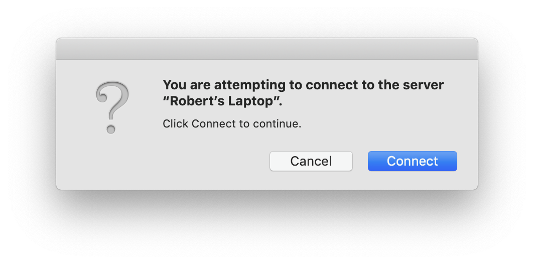

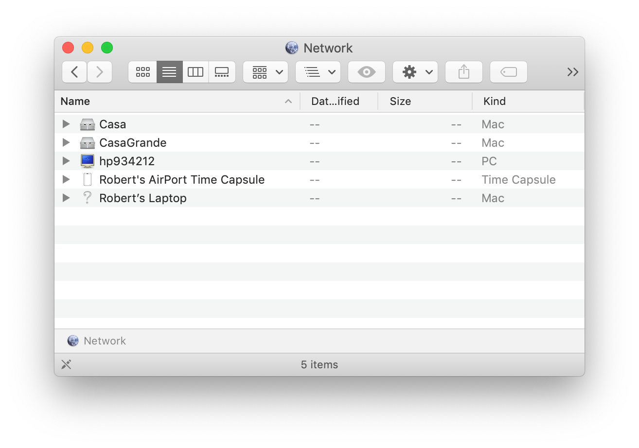

I have for years had an 2017 iMac (last running Ventura) and a 2018 Mac mini (running Mojave) on the same Ethernet network and have been able to transfer files from the Mini to the iMac over the network. Now, I've replaced the iMac with a closed-lid MacBook Air M3 (running Sonoma) *without an Ethernet connection*, but on WiFi. I can't login to the MBA from the Mini as admin:
Note the "?" icon for the laptop. When I try to connect as admin, I'm rejected.
Any tips or ideas on this problem? Could the WiFi-only connection be an issue? Are there system settings on the MBA that I should look at?

Thanks, but did not work using SMB://IP address. Also don't see any obvious issues with firewall.
Interestingly, the 2017 iMac running Ventura (which is still here) has no problem connecting to the MBA on WiFi. So, I'm wondering if it's a conflict between Mojave (on the 2018 Mini) and Sonoma. I can't upgrade Mojave because of a needed app, but maybe a downgrade of Sonoma to Ventura on the MBA would fix?
