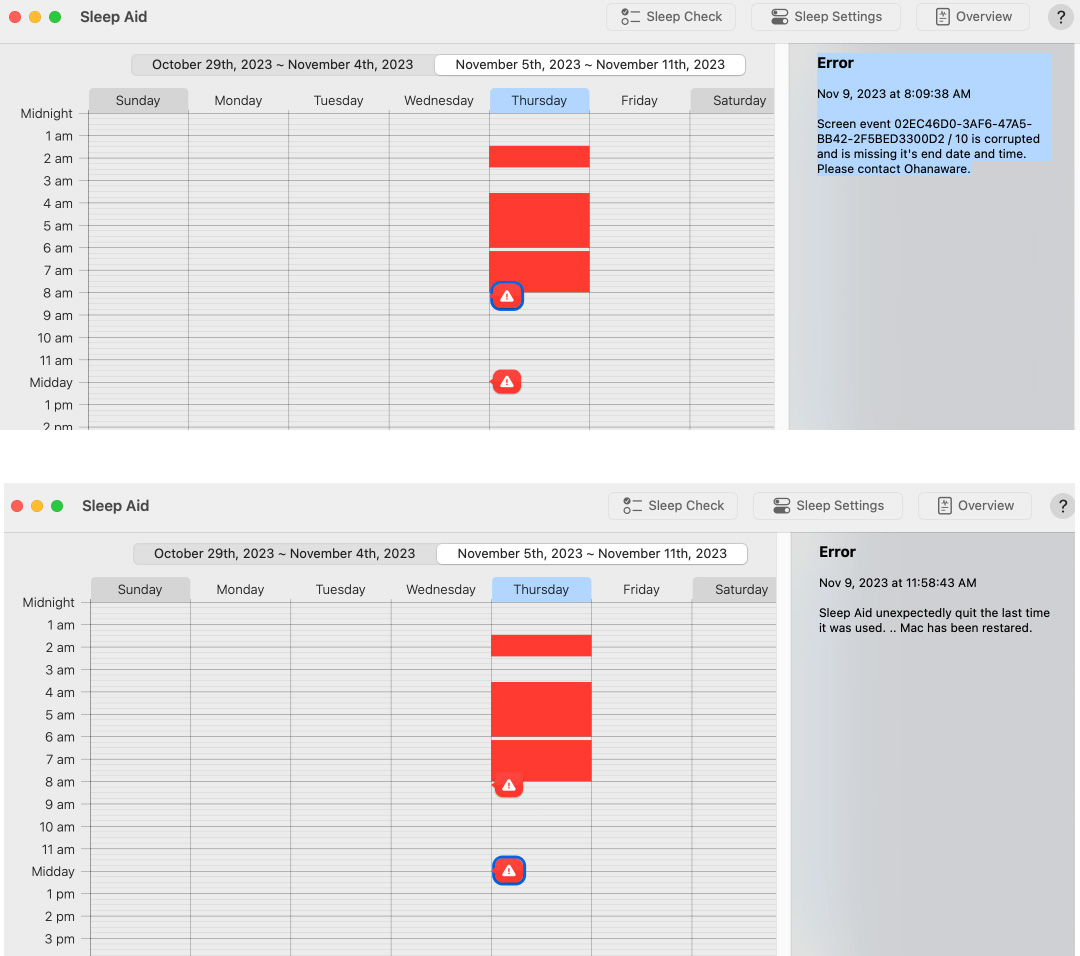

Well, I guess moving my third monitor to the third bus did not fix my problem.
I installed Sleep Aid last night. I usually sleep myself between 6am and noon, but today I happened to wake up at 8am briefly and noticed my computer screens had woken up as I have a CCC Backup that takes place every morning at that time, and I could see the Desktop icons at that time - so no crash as of 8am.
When I finally got up at noon and touched the keyboard it was obvious the computer had restarted and asking me to login folllowed by the familiar Kernel Panic report. I opened Sleep Aid and this is what it showed - not sure what it means?
Does anyone have any idea what this error message might be indicating?
Error
Nov 10, 2023 at 5:31:55 PM
Screen event 35D90B59-0B65-4B35-A9B6-42FFC4A0FE4C / 59 is corrupted and is missing it's end date and time. Please contact Ohanaware.
Seems like every time I crash during sleep I get a similar message in Sleep Aid but with different Screen Event numbers? I contacted Ohanaware yesterday, but have not heard back.
