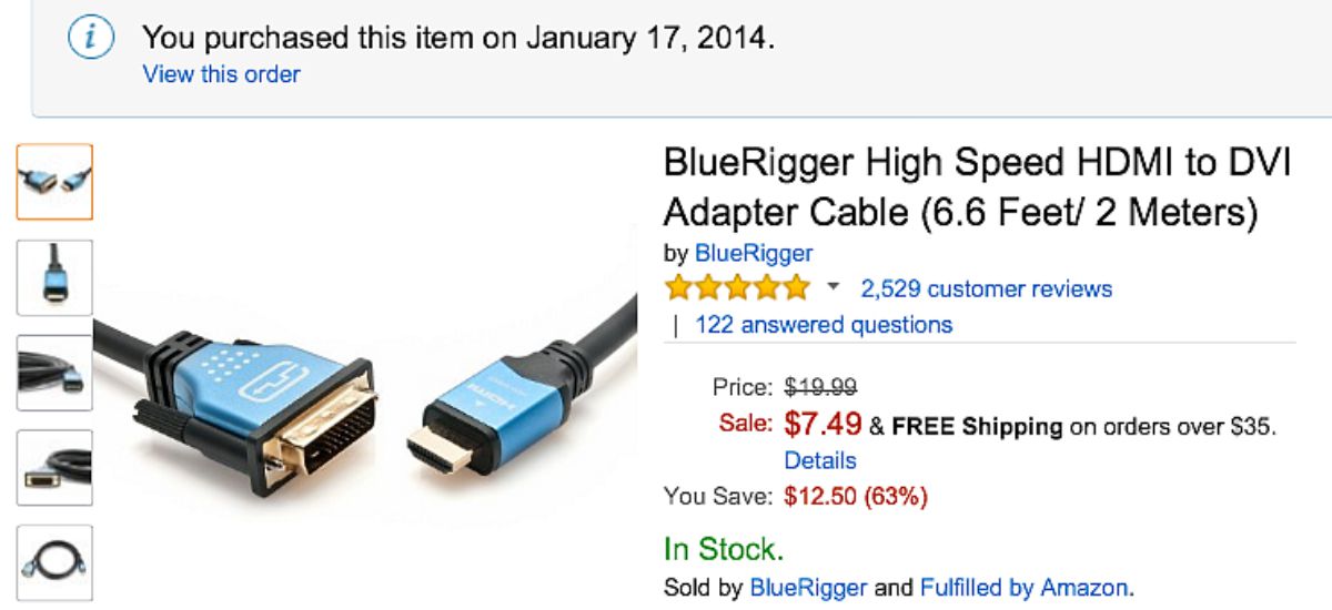

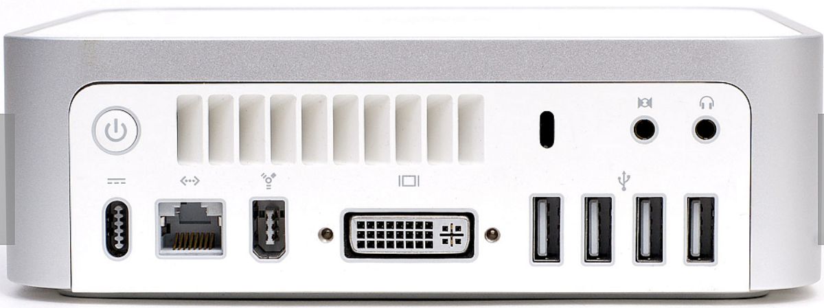

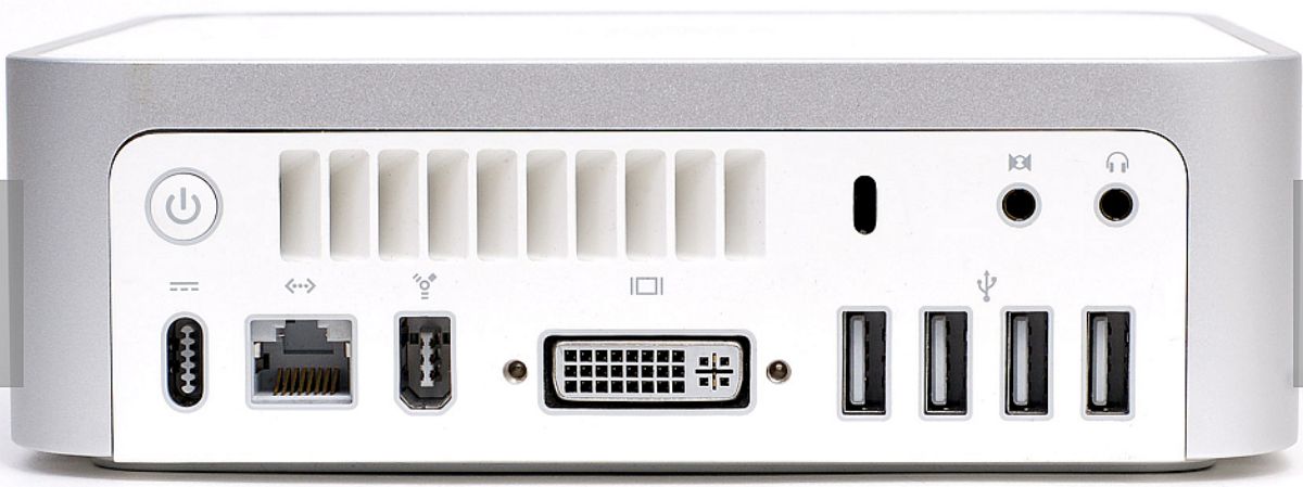

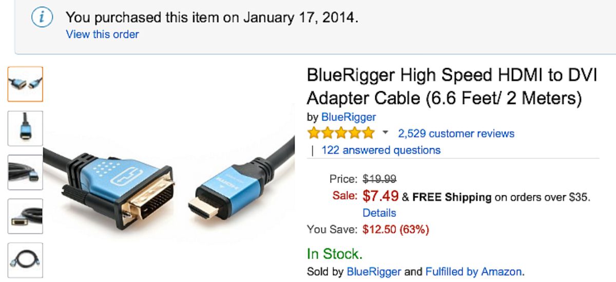

Connect your mini's DVI-I port to the HDMI port on the TV with an adapter cable or an adapter plus a cable. The DVI port is the rectangular middle one on the rear of your mini. Amazon has plenty of cables for less than $10.
