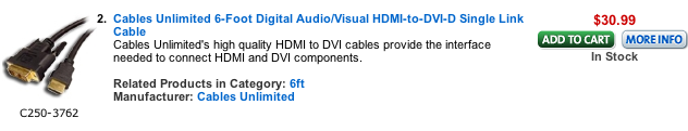

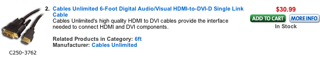

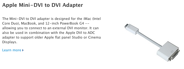

You want a mini DVI to DVI and then use a DVI to HDMI cable. My widescreen looks awesome with this setup.

Thanks so much for all the useful information 🙂 I found out stuff that I never would have even thought to ask, like what cables to use (turns out the old cables I had wouldn't even work with a new tv to begin with!) So, what I'm going to do is, buy a widescreen tv with an HDMI input on Massachusetts' tax-free weekend. 😉 Then, get two cables - a mini-DVI to DVI and a DVI to HDMI. You guys just saved me a few more posts down the road!
