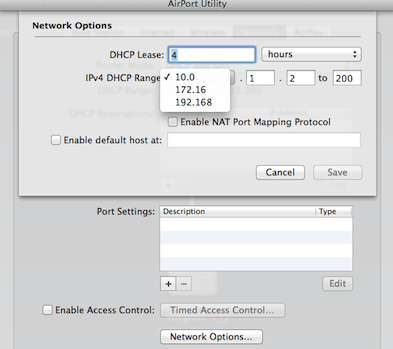

I have the newest one, same as you 7.6.4 I could only use 10. when setting things from my mac but from my iPad (device I'm on now) I could use the 192.168.2.x range in DHCP and NAT
So it depends on the AU version : in 5.6 on Mac you can create a 192.168.2.x range.
In 6.3 you only have 10.1. as you said. (EDIT : wrong, see below).
