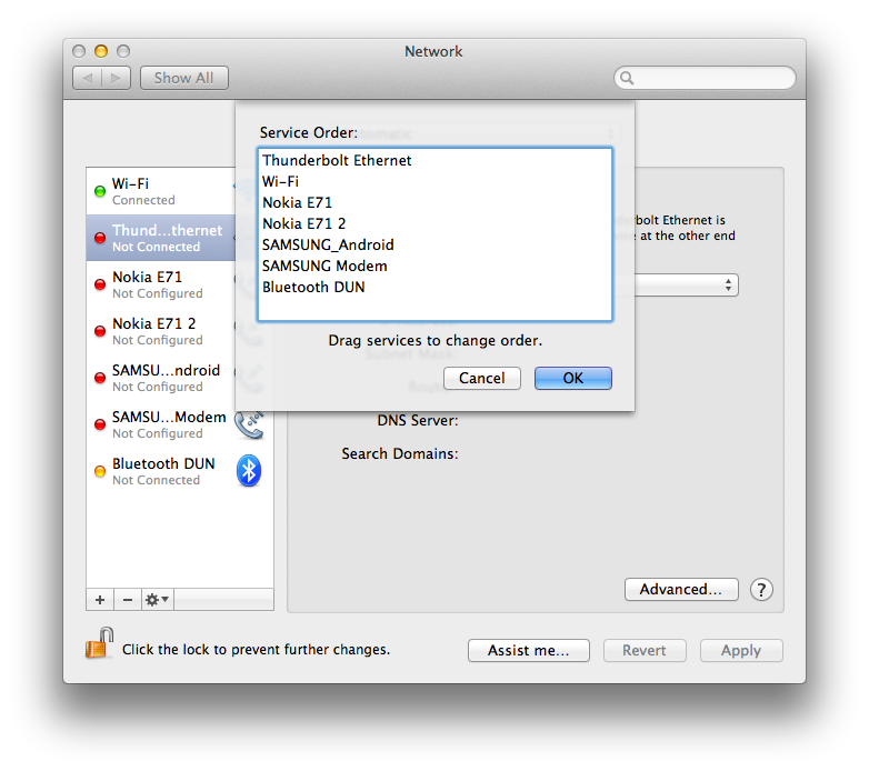

In System Preferences, you can set the service order to choose the priority that one network takes over the other. You can be connected to a LAN and a Wifi connection and send data over both, but only one will provide your internet connection. If the computer is able to connect to another device on your network through the port that has priority, it will use that, but it will use the other if it's not available through the first. Thus, if you have devices that only connect wirelessly and you connect to the internet via LAN, you can be online through the LAN and transferring files over Wifi, or vice-versa. This is a fairly unusual setup overall, though.

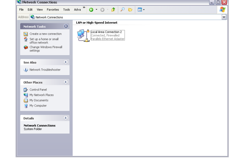

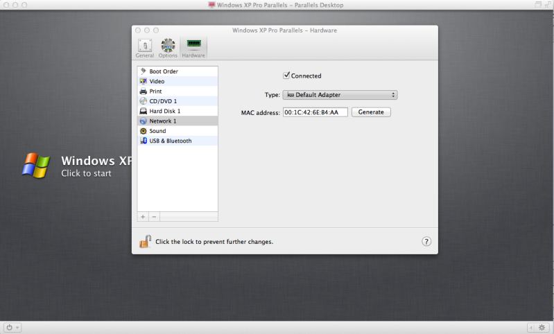

I need to remote connect (via teamViewer or equiv.) to a XP SP3 virtual machine running in Parallels Desktop 8 on Mac OS X (10..8.4).
The VM is also using the ethernet port of its host to connect to another computer to retrieve data.
It doesn't seem possible to maintain both WiFi and Ethernet connections on at the same time. Right it's either or.
Anyone knows a way to do this?
In the VM, there is only one adapter. Is it a matter of adding another one?
Following problem with mine setup - have iMac 2013 connected to internet via time capsule (wifi) but need to connect dental 3D x-rays via lan. Mac wont start internet connection without pulling out the lan cable. Is there a way to tell to mac, that it should use wifi for internet and the fixed ip adress only for x-rays?
