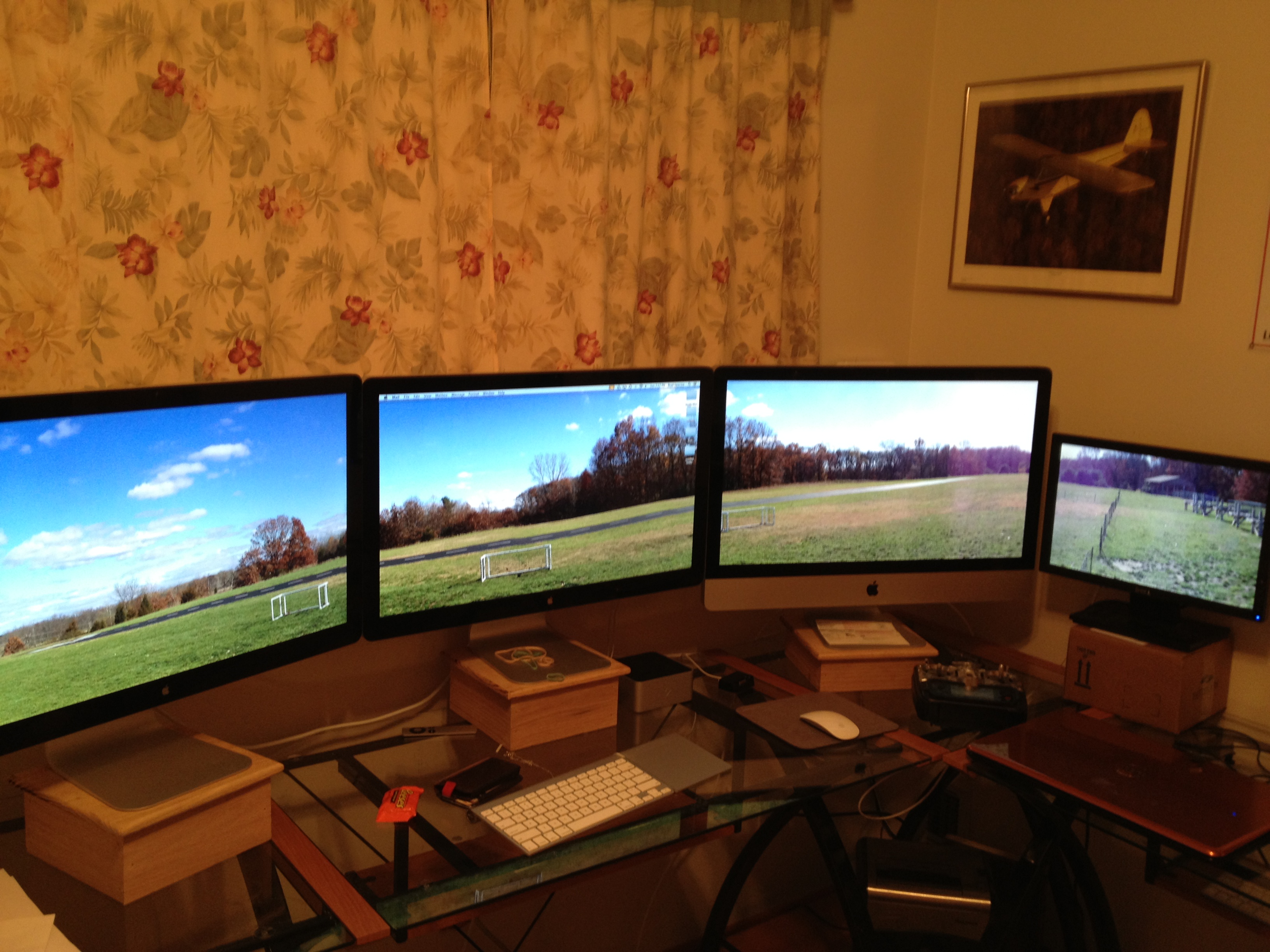

daisy chaining Thunderbolt monitors is possible
i have two on my iMac PLUS one dell monitor connected by mini display
i do plan on turning that dell display into a thunderbolt display..
so far the graphics can take full screen video on all of them at the same time without lag
-Menice
