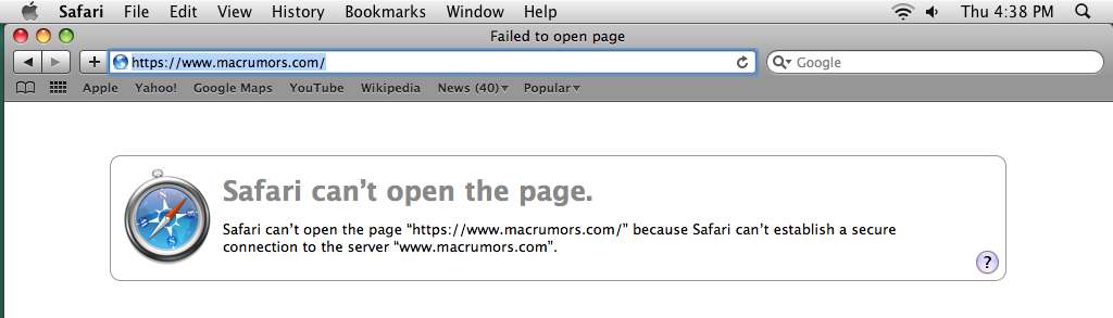

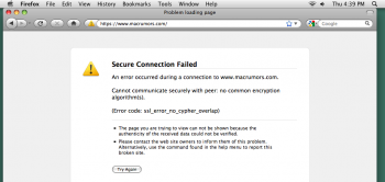

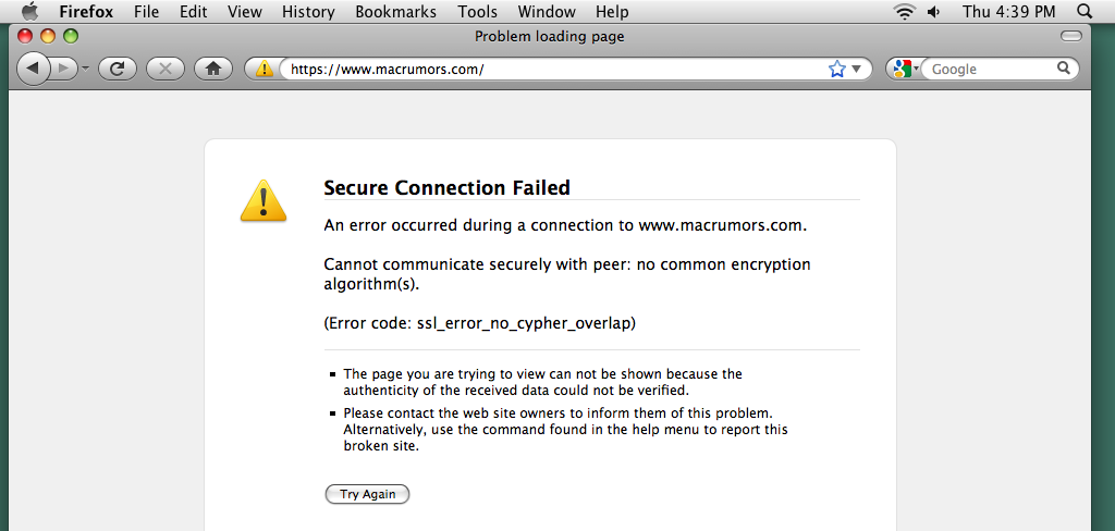

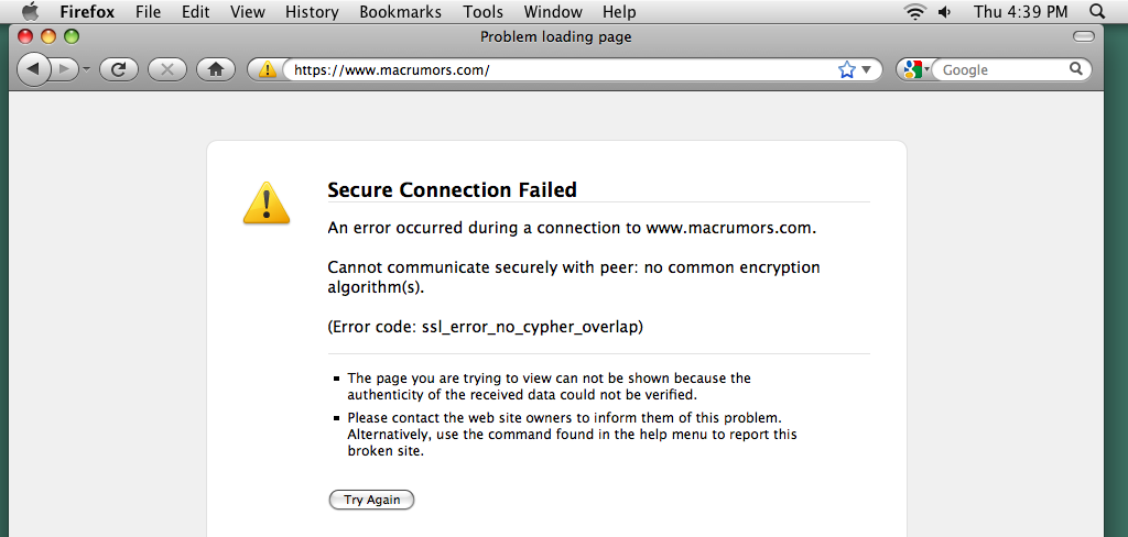

I have a working 15-inch iMac G4 running OS X 10.5 Leopard (not officially supported by Apple, but there's a way to "fake out" the installer).
The latest version of Firefox that can be run on any PPC Mac is 3.6.28. With this I can successfully access https://www.google.com/ or https://www.google.co.uk/. Same with Safari 5.0.6 (which is the latest that runs on Leopard).
However, even running the above software, you will find MANY sites that cannot be accessed, including Macrumors. 🙁

View attachment 752900 View attachment 752901
Thanks for posting those screenshots.

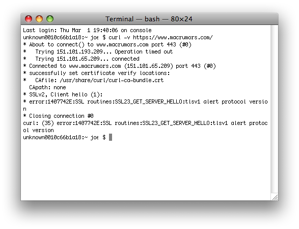

The failure in connecting to MacRumors is due to HTTPS protocol failure. Essentially, MacRumors web-server is trying to negotiate for a more secure SSL/TLS version than that Safari version knows about. Another way to think of it is the MR server isn't willing to negotiate downard to an SSL/TLS version that the older Safari can work with.
You can see more details using this Terminal command:
Code:
curl -v https://www.macrumors.com/
The output should show something similar to the following (NOTE: this is from 'curl' on Snow Leopard):
Code:
* About to connect() to www.macrumors.com port 443 (#0)
*   Trying 151.101.25.209... connected
* Connected to www.macrumors.com (151.101.25.209) port 443 (#0)
* SSLv3, TLS handshake, Client hello (1):
* error:1407742E:SSL routines:SSL23_GET_SERVER_HELLO:tlsv1 alert protocol version
* Closing connection #0
curl: (35) error:1407742E:SSL routines:SSL23_GET_SERVER_HELLO:tlsv1 alert protocol version
We can tell that DNS lookup worked, because an IP address is listed ("Trying ..."), and the connection is made on port 443. After that, the protocol negotiation fails.
