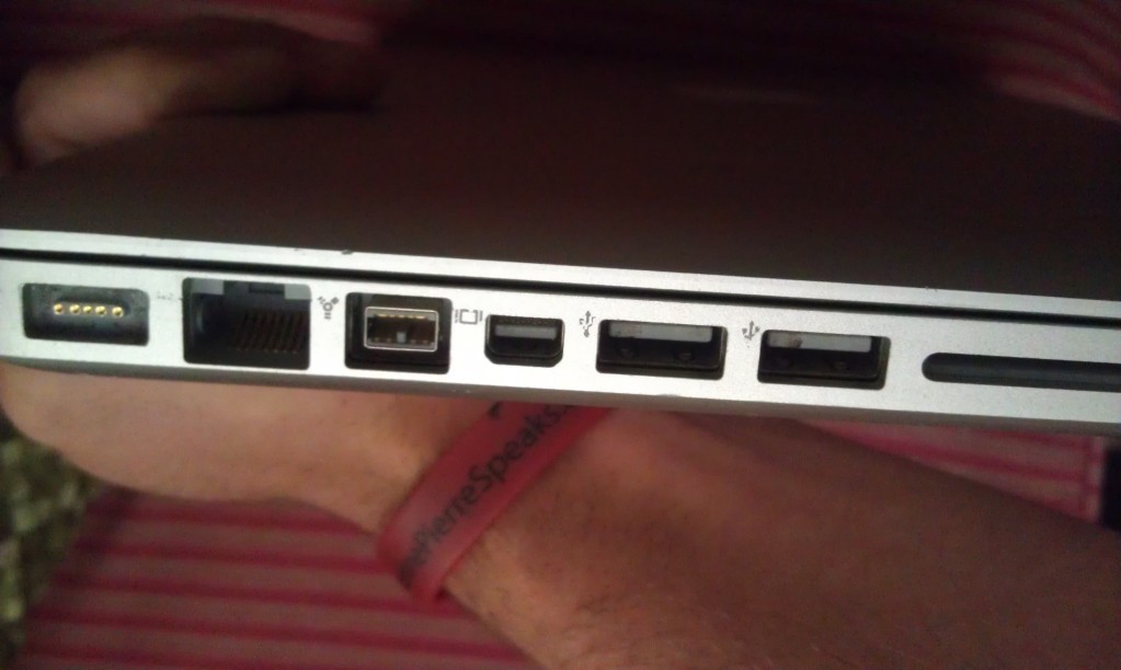

    Forgive me for bringing up an old thread, but the link to the male-male yellow lead is broken. Also, how is the end of the male lead for yellow going into the mac book? Is there a spot for it?
    My MacBook has the follow ports/components:
    [​IMG]
  10. ftaok macrumors 603

    You have a miniDP port for video. It's the 4th port from the left.
    Depending on how much you want to spend, you could do it two different ways.
    1. Get a miniDP>VGA adapter and a VGA>RCA adapter. Also, you'll need a mini-jack>RCA audio adapater for sound. You'll have a bunch of cables and adapters in this set-up and depending on what you get, it may or may not work. You'll have to test or research the set-up.
    2. You could get a $50 miniDP>RCA adapter/converter. I found one on Amazon and some of the reviews says it works with newer Macbooks. Here's the LINK.
    Keep in mind that the resolution will be 640x480 and will look like crap on the TV. I used to mess around with my iBook and a CRT TV. It's OK for watching a movie, but it's crappy for just about anything else.
    IMO, it's $50 down the drain. I'd rather take that $50 and use it towards a new HDTV with proper digital inputs.
