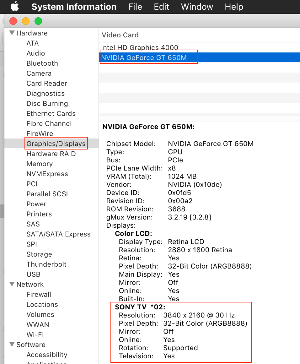

What do you see in System Info under Graphics/Displays?
HDMI-connected display shall show up there.
PS If your rMBP has dual GPU, you need to make sure you are running either default autoswitching mode or the dGPU (nVidia). Integrated one is not connected to HDMI at all. If you have installed the gfxCardStatus and switched permanently to iGPU, then this will also result in no picture via HDMI.
