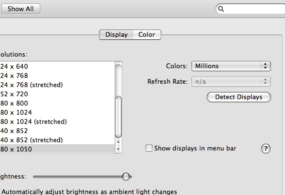

also your MBA will be able to do screen spanning - you'll have the screen on when you plug into your tv in prefs and display there should be detect display

I got my macbook air to display on my monitor, because I was able to change the resolution to something that works for my tv. Now is there a display profile file I can copy over to my mac mini so it will use the correct resolution. Like for example the Color Profile file in /Library/ColorSync/Profiles/Displays/LTV-27w7\ HD-2149C1C1.icc
I tried copying this file over but it didn't work because this mostly deals with the color and not the resolutions. So is there a monitor or display file that will do the trick?

Well I got it to display correctly on my TV. I vnc(ed) into my mac mini when plugged into the tv and changed the resolution to the one that my tv likes and it finally displayed on my tv.
