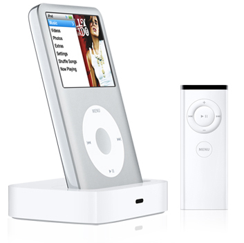

The OLD Apple iPod Universal Dock
Well, sort of. I believe your link referenced the NEW Universal Dock, the one that has a smaller, rectangular infrared window on the front. The one I have is the older one, with a larger, round infrared window. I can only vouch for the latter, which I know outputs video from the 3rd gen. Nano.
The older one (round IR window) has an S-video jack, a regular iPod connector (for power and charging), and a 4-conductor 1/8" jack that outputs video as well as left and right audio. 🙂
The newer dock (rectangular IR window) has the iPod connector for the power and charging cable, but doesn't have the S-video jack, and only provides audio on the 3-conductor 1/8" jack. Apple prefers users get the special A/V cable and use it for video with this newer dock. 🙁

Old/Original
Current (i don't see a picture of the back)
older iPod dock

Just make sure you get the genuine Apple dock. A few third-party manufacturers made almost identical-looking docks, but I can guess that they wouldn't work for the video on the 3rd gen. Nano.
The Apple dock has the gray rubberized pad on the bottom, with the Apple logo :apple: "iPod" and "Model No. A1153" embossed. And again, it's the one with the ROUND infrared window on the front.
TraceyS: thanks for the photos!
