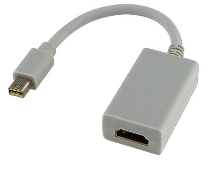

I am trying to connect my Macbook Pro to my HDTV and am able to see the video just fine. The problem appears to be with the audio. I purchased the following cables and connected the mini display port to my laptop, I then connected one end of the HDMI cable to the mini display port and the other end to the HDMI2 port on the TV. When I select the input as HDMI2 on the TV I can see the audio just fine, the problem is with the video.
I went to the Apple store and purchased a Belkin Y adapter cable, and one end of the cable is connected to my laptop's headfone outlet.. The other end needs to go to my TV and I am unable to figure out where this should go as the HDMI2 ports do not have a separate audio-in ports. Please advice. I am running out of ideas and spend the whole damn day trying to get this thing working...

I thought the HDMI port carried audio as well as video. I presume the mini display port lacks this ability even when "converted" to HDMI hence the lack of audio?

As far as I know, the MDP will not support audio, at least my '09 MBP doesn't. But you can get an adapter that will carry it from a USB port. There are several options on Amazon link provided above.
That would probably be your easiest route.

The 2010 models do support audio over mini displayport, but the poster never said what model he/she has nor have he/she made it clear what exactly is going on. Are you missing video or audio?

Go into audio midi setting in utilities, change it to 48000Hz at 16 bit with the HDMI option selected. That fixed my issues with audio through HDMI with my Toshiba TV.
