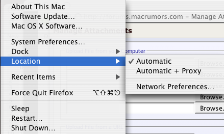

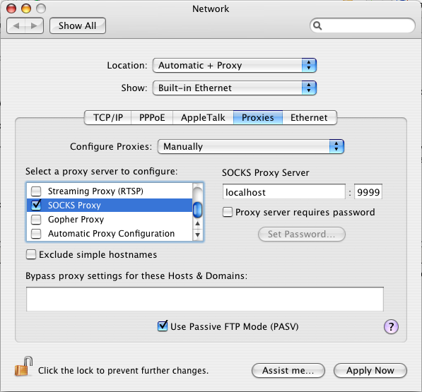

I setup a new Network Location called "Automatic + Proxy", which I only use at work, when I'm plugged into the Ethernet.
I switched to that location and then put my proxy server information into the Socks Proxy tab. The proxy server I use actually runs on my Mac, thus the localhost 9999, but I've used it at other job sites where the proxy server was an official one not hosted by me.

You can setup "Locations" in the networking area, but it requires you to click on Apple > Location and pick the appropriate one when you move around. A lot quicker than having to edit the entire network preferences manually each time.
Aha! Just what I was looking for aristobrat. 😀
