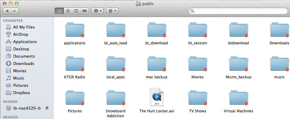

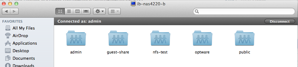

I have recently upgraded from OS 10.6 to 10.7 and am now having problems with SMB shares from my NAS box.
If I map the share in finder I get a problem where it says permission denied and the folder had a red no entry sign on the icon. But If I SSH into the NAS as either root or Admin and check the folder permissions that seem ok. I cannot map the drive as root because its an internal account and can only be used to gain access via SSH.

But If you compare that to the screenshots of the folders in finder I am confused as to why I can't gain access.

I have exactly the same issue here.
The strange thing is, I can browse the folders in terminal, and also open documents in the folders that are denied in the gui.
Also, it seems it`s just directories that are denied in Finder, and not files on the root share level.
I`m pretty sure you would be able to play The Hurt Locker.avi file in the screenshot.
I could open documents on the root share folder, but not directories below.
