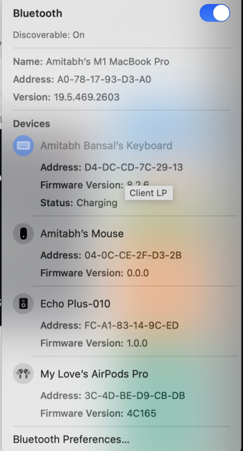

I have removed it from iMac, and dont remember with which mac i have connected it before, i tried following steps in the link to reset the device but there is no such option to reset device attaching the screenshot

I have just checked in keyboard that if my Magic Keyboard is plugged in with lightning cable it was showing me 40% charged but as i disconnect the cable it disconnects from the bluetooth and when i again plugged in battery shows 3% charging, battery draining out instantly from 40% to 3%, if i plugged the keyboard and track pad with power outlet then it connectes my m1 macbook pro, its a issue of battery of the magic keyboard and track pad, i have not used them since 4-5 years and they were kept packed, what should i do to recover the battery issue?
