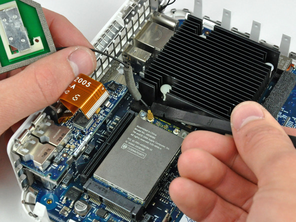

Did you recently upgrade hardware on your Mac Mini like the hard drive as I did recently? Well, chances are the reason you're connection is timing out and you're not getting wifi is because the antenna got disconnected like mine did. You should check this to eliminate the possibility but I spent a good chunk of time pulling hairs out thinking it was a some network/router setting or .plist file I had to delete when all along it was the AirPort antenna cable connector that had easily popped off from the AirPort card.
