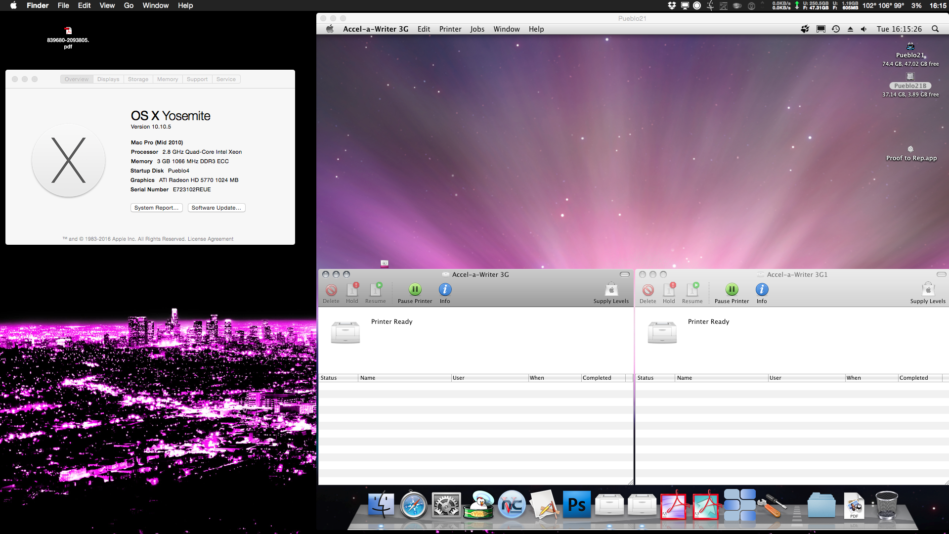

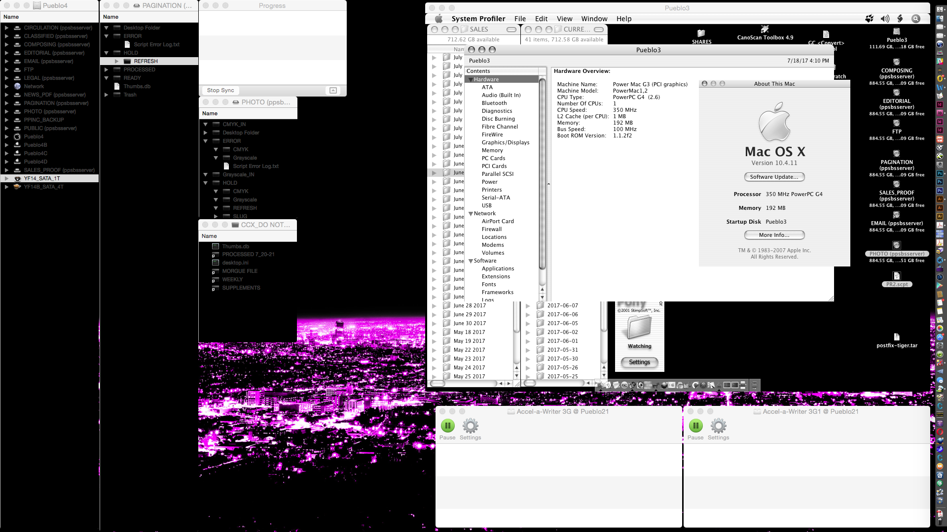

PowerMac G4 (on the left). Applescript server (process photos, move files around server shares, watch FTP folder for changes, email if there are).
Both Macs in the picture are headless, meaning no video cards. I access them via VNC (Chicken of the VNC showing the desktop of the Tiger G4).

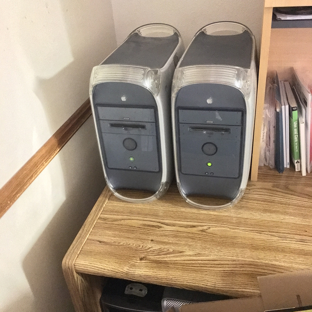

[doublepost=1500419799][/doublepost]Here's the other G4 by the way…
Print server so my Mac Pro can print.
